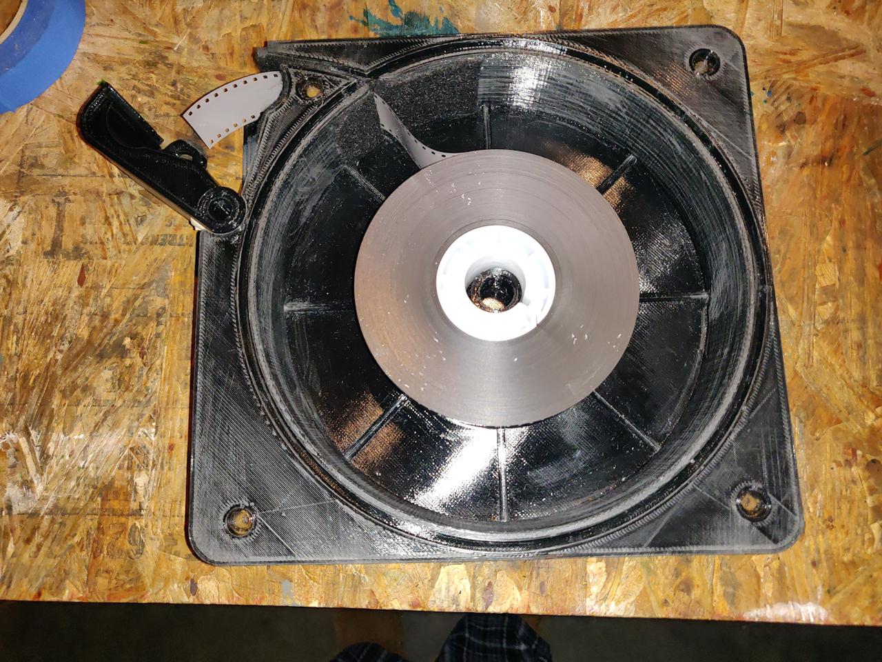

Well, I'm biased because I designed it. I have three of them and they have been working well for me. I can roll with a little less waste.
I might do a version for 100ft rolls. I do have Alden and Watson loaders, but they are awkward to store
