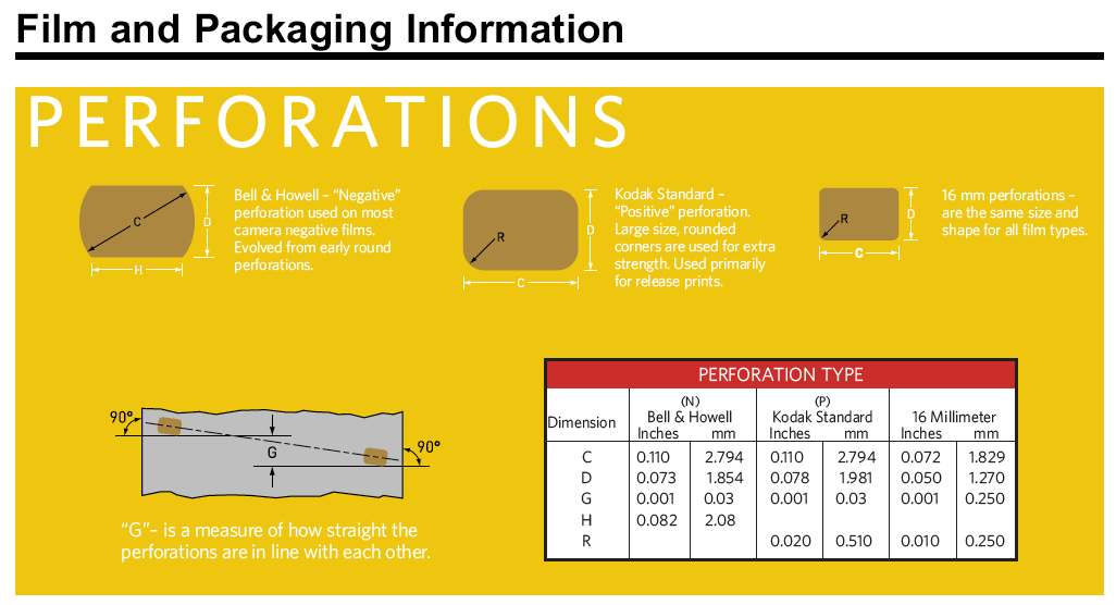

Fair enough. Question, are the sprocket holes the same as regular 35mm camera film?
No, motion picture film has "Bell and Howell" perforations, while still camera film has "Kodak Standard" perforations. The big difference is that the B&H perfs have rounded sides, which basically makes no difference at all since a camera is pulling on the other side of the perfs anyway. Somewhere out there must be a still camera that somehow can't cope with the different width of the perfs due to the rounding, but I can't imagine what that would be. Works just dandy in my old manual focus Canons, and every other camera I read about people using it in.
Here's the Kodak diagram of it from the Motion Picture Products Catalog:

btaylor
Dec 28, 2010
2,299
Los Angeles
The B&H and KS perf differences are not important for still camera use, both work just fine. If you're running it through a motion picture camera at 24 fps it can be critically important.
frobozz
Feb 19, 2010
1,458
Mundelein, IL, USA
Yes, when I said "basically makes no difference at all" I was referring to using it in a still camera. Of course it makes a difference for motion picture cameras, which is why it's perfed that way in the first place.
