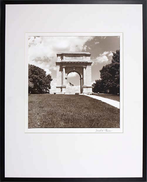

This year, to mount prints about 10.5 inches square, I cut the inner mat to about 10.3 inches square (optically centered for 16 x 20 frame). The outer mat I cut for a 0.3 inch reveal on sides and top, 0.5 inch reveal on bottom where I stick my signature. For those of us who cut our own, I note that making the reveal extremely narrow tends to show flaws in the dimensions more noticeably than with a wider cut.
Thanks for mentioning that - it's very useful info.
DaveT
Which is one reason (as well as personal taste) why I standardized all sizes of my windows (8-ply), from 11X14 to 36X48, to a half inch well all the way around, despite the fact the above essentially replicates Adams' recommendation in The Print.
