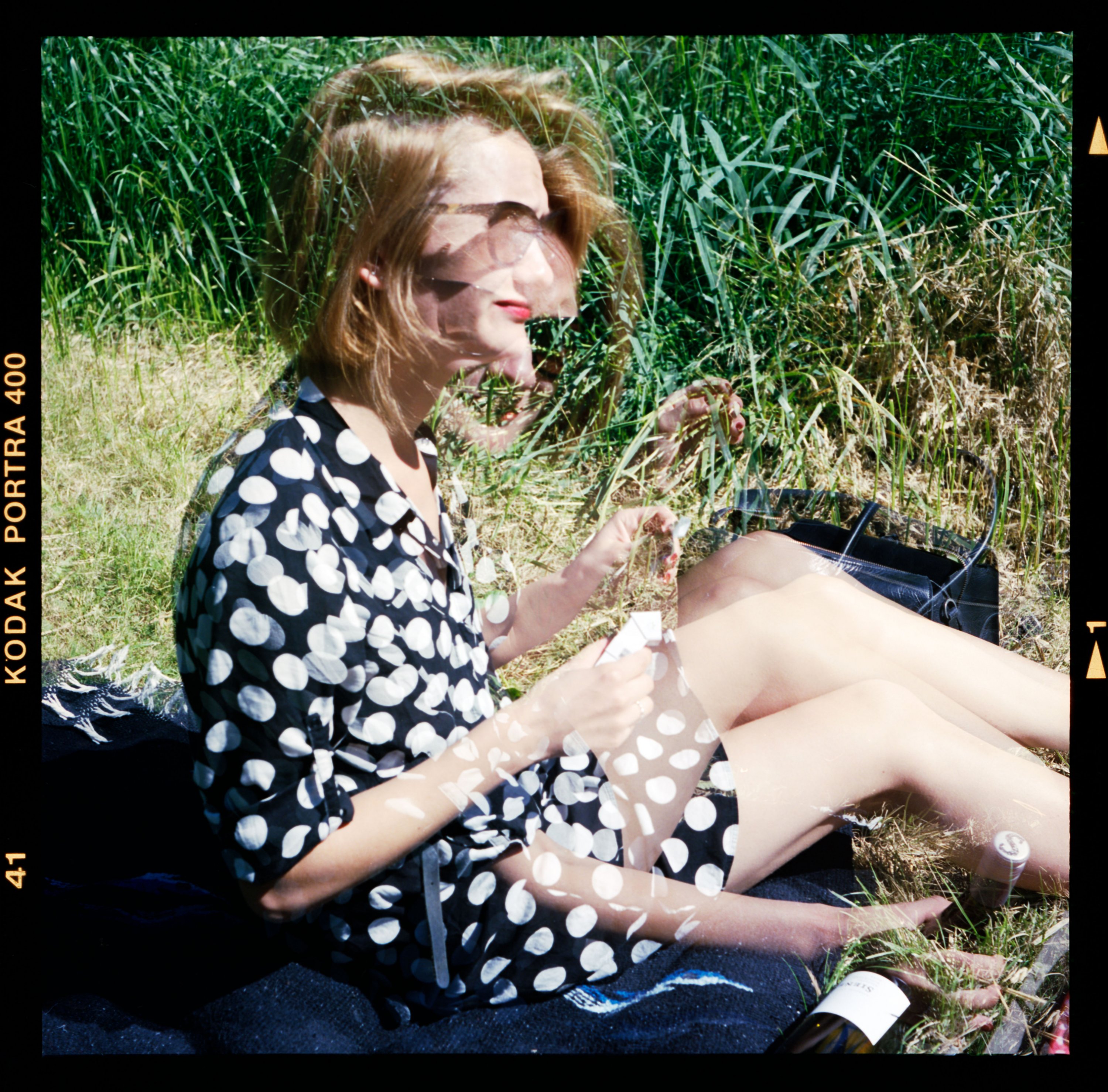

Hello all.
First post here at APUG so bear with me. I am mainly a 35mm B&W shooter but I have "inherited" an Automat K4A that has recently received a CLA from a reputable tech here in The Netherlands so I think everything should be working fine. Actually it is. Images are really nice. That negative just kills it. Now if only I could take better pictures :smile:
Anyways, I recently shot a roll of color film (Portra 400) which gave me some lovely results. But, the first image was double exposed. Not that I mind but from what I have read, double exposure is not possible with this model? Would be cool to know how to either repeat or avoid it.
Thanks!

It is possible for the shutter to not get cocked fully during the winding stroke. There is rotating part that pushes the cocking ring in the shutter; if this ring gets pushed almost to the locking point but not quite to locking, sometimes the shutter leaves will open as the cocking ring returns to the uncocked position, sort of a 'false firing' of the shutter.
There is a difference in exposure between the two images on your film. I assume that the lighter ghost image is the one that you didn't take deliberately? This throws my theory off a bit as the 'false firing' is usually slower than an regular firing as the motion of the wind lever creates the opening and closing of the leaves. Maybe the aperture was closed down as you wound the film into position, then opened up for the shot you took deliberately?
Anyway, do some test firing. Different speeds- B, 1, and 1/250 and 1/500 being the most likely problem speeds. Also move the lens board from one extreme to the other, especially set for closest focus. During all of these, watch the lens to see if the shutter leaves open during any winding. If it happens as all, which it shouldn't, call your shop and arrange for them to adjust this. The side panel needs to be removed, at which point the adjustment for the shutter cocking is accessible. Seriously, one instance of false firing means it goes back to the shop!
Well, just an idea. I'm not certain if this is what really happened in your case.
If 1/500 isn't seen, be sure the shutter is not cocked before pushing the shutter speed dial past 1/250. 1/500 is 'hidden' around the corner. You shouldn't change speeds to or from 1/50 with the shutter cocked.

Welcome to the forum. Sometimes Rolleflexes that haven't had regular recent use will have film transport issues when they are used again but your statement about a recent CLA puts that to rest hopefully. Just generally speaking, another point is that it's sometimes possible for funny things to happen if you crank them over too rough or vigorously, so use a gentle but consistent stroke on the lever if you can. Some of these cameras have a button close to the crank to allow for multiple exposure but seem to recall that your model doesn't allow for this, as you already suspect. Might be worth noting what films and types it happens on, see if you only get the fault on one kind of film / thickness. Film transport problems on Rolleiflexes always seem more likely to happen with the first frame (as with yours) and then sometimes take a couple of frames to (often) straighten themselves out again in my experience. You shouldn't be getting this every time though so would be interested to see what future rolls hold in store for you.

I think the clue is in the fact it was your first shot on the roll, my only conclusion is that you wound it on and you somehow managed to take a the first shot without the camera being fully engaged and then it moved on slightly and went into the correct first shot position where you double exposed it. Just make sure the camera is fully engaged for the first shot next time and that the film is thread the right way through the rollers........This of course is just hot air guess work also did you make sure that thin strip of holding paper was removed from the film before loading.pheraps that could have effected it.......Who knows.
My one gripe about my model of Rolleiflex is the fact that you can't just use a empty reel of backing paper for testing the cameras out because of the thickness sensor.....Like I said all can think off unless it as a fault.:smile:

Thank you Dan, Chromacomaphoto and Harry for your replies. I have shot 2-3 rolls of Tri-X in the past (again, those negatives...) and this never happened so who knows, maybe it is the thickness of the paper as Chromacomaphoto suggest as I never shot Portra before.
I will pay attention on how I load, and be gentle with winding etc. So used to my M4 and the tank like aspect that I foget how fragile a Rolleiflex is/can be. I am going to load some more Portra in there and see what gives. I honestly think this was a fluke but it never hurts to check with people who's experience runs deep and I will keep you all posted.
