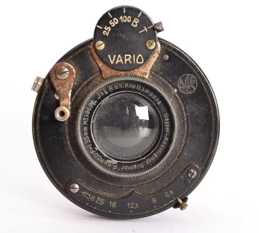

I know this lens could have broken beyond the repair and it has f/6.8, which could be a copy of dagors. Are these lenses any good?

There are 5,5 and 4,5 versions as well: https://www.engel-art.ch/knoll/ and
"Eho-Altissa was founded in Leipzig in 1892 as Richard Knoll's "Photo Spezialhaus". By 1904 they were repairing and building photo equipment. It was moved to Dresden in 1910, and was acquired by Emil Hofert in 1927, and later by Berthold Altmann. The name was changed to: EHO- Kamerafabrik GmbH in 1931."
The name "Rigonar" was later used by Balda for a triplet on their Rigona cameras.
I think it's more likely that the Doppel-Anastigmat Rigonar is a four element dialyte or double-Gauss lens, or maybe both depending on the version, than a Dagor. A cheaper version of the 5,5 and 4,5 versions, hence the 6,8 speed and cheap Vario shutter. The lenses were probably not made by Knoll, but bought in from a lens manufacturer. ICA Hekla is another 6,8 lens that is a double-Gauss rather than a Dagor.
A Dagor-type you can find for little money is the ICA Doppel-Anastigmat Maximar in 6,8 and 5,4.

Announced in Photographische Welt in 1906:
'The Rigonar F:4.5, F:6, F:6.8 is brought to market by the company R. Knoll, Leipzig-Oetzsch. It is a spherically, chromatically and astigmatically perfectly corrected lens, free of any distortion, the coma is completely eliminated so that the images have an excellent brilliance, the plate sizes are cut sharply right into the corners when the full light intensity is used, and the instruments are free of all annoying reflections.
The light intensity of the Rigonar F:4.5 is still perfectly sufficient for taking pictures in the studio even in cloudy weather and is therefore particularly suitable for this purpose. The Rigonar is symmetrically constructed so that the rear lens can be used on its own as an excellent single anastigmat of around twice the focal length of the system with great success for landscape shots etc.
Due to their compact construction, these instruments are perfectly suited for installation in hand-held and folding cameras of all designs. The company is willing to send any instrument for 14 days for testing.'

If you manage to clean the lenses and the shutter op I think you might probably be able to make some fine photos on 6x9 cm and 9x12 cm. Why not give it a run for the money?

The Vade Mecum mentions Rigonar lenses 3 times, used in the 1950sby Balda, another Dresden based company.
The Rigonar here is much earlier, pre 1930the Vario shutter indicates it is most likely a budget lens. Probably the style of the Vario shutter might narrow the time frame. Probably closer to 1912 when the Vario was introduced, Richard Koll moved Eho-Altiss moved to Dresden in 1910..

Yes, but it's a completely different lens design. How Balda came to own the name "Rigonar" is a mystery.

Balda used other manufacturers lenses before WWII on some of their cameras, so it's quite possible they bought in Rigonar lenses from Eho-Altissa, by 1952 nationalised as VEB Altissa Camera Werk, who were also in Dresden.

I doubt that the lens is beyond repair but the shutter probably is. Is it possible to replace this Vario shutter with a better model like a dial-set Compur? Are they compatible?

Or perhaps Balda bought some parts of Knoll's company when it was taken over by EHO-Altissa? Balda made a 3x4 Rigona camera for 127-film in the 1930s, well before the postwar 24x36 Rigonas.
