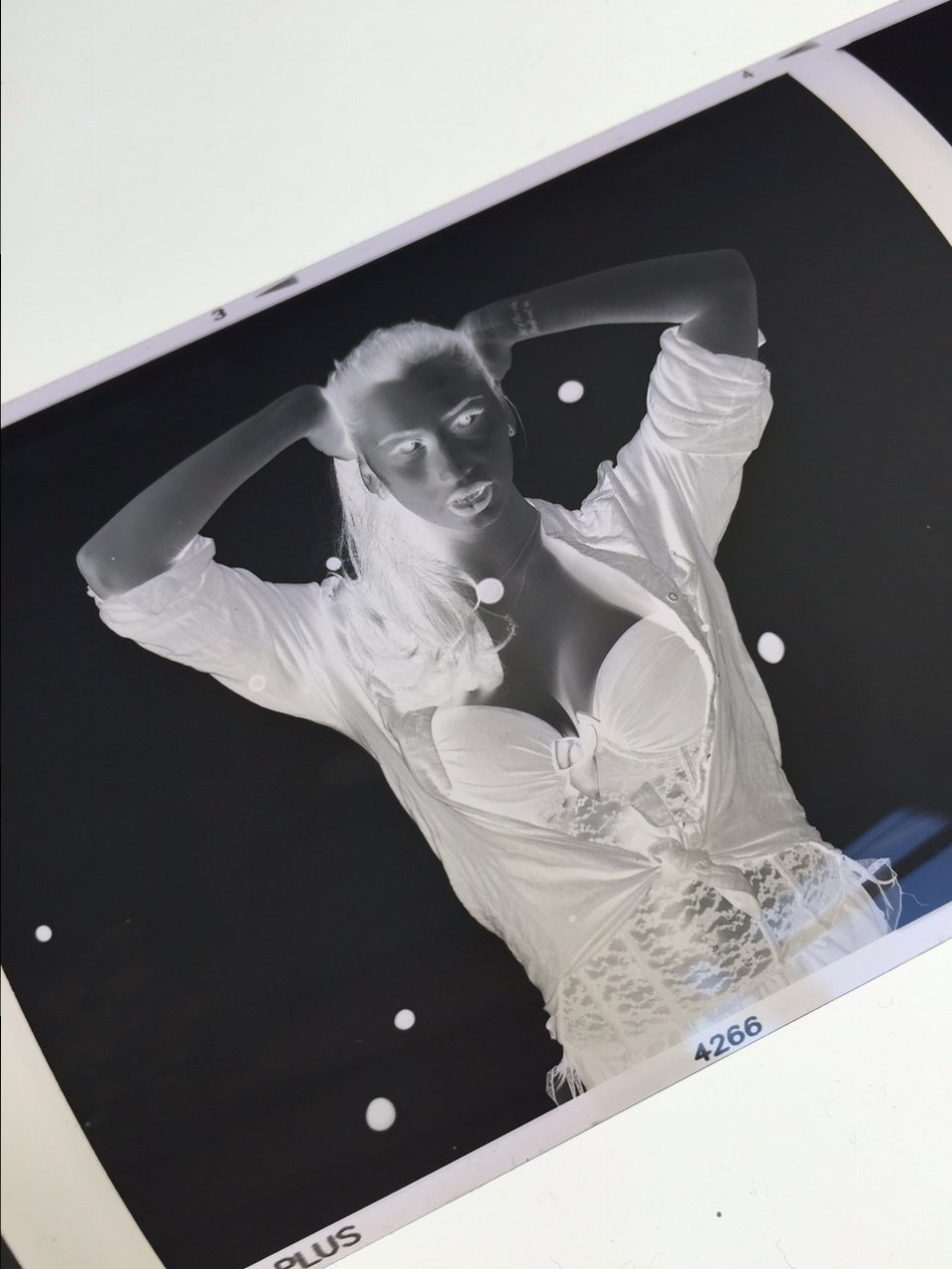

120 FP4 developed in Paterson tank, in R09. Done many times before, with correct agitation, every minute for the reccomended 8 minutes, but this time dots on first two frames, nowhere else.
The tank was used yesturday and fine, today film was put in and developed within 20 minutes.
Any suggestions
Looks like a classic case of air bubbles to me. You usually dislodge these with the initial agitation, and they almost always are gone with subsequent agitation, so it is amazing how clear and distinct these are. The second thought is something adhering to the film. But material adherents usually have at least somewhat jagged edges; these are very smooth and rounded. Oil droplets are also a possibility. Could something have spattered onto the film? Manufacturing defects are a possibility, but they are highly unlikely. The distribution of the spots may give some clues. Are they localized to this frame and maybe the immediately adjacent frames? Is this frame at either the beginning or end of the roll (or very near)? Or does this happen throughout the roll?
some of those spots are lighter than the film rebate. There is no development on them at all. That suggests they are not air bubbles because they wouldn't remain in position throughout development.
I suspect a film defect or film contamination with something, probably at factory but maybe in camera. Have you just had it serviced or used some lubricant in film back? i.e. some oil as suggested.
Do you still have backing paper, if so check outside to see if there are oily spots on it.

It is on the first two frames only, which would have been on the outer of the spool. I ALWAYS agitate, at start of development and then every minute, and bang the tank to dislodge bubbles. Have developed about twenty films, in the last couple of months and no faults. before that I developed many 35mm films since college without this ever happening.
The only thing I can think of was that there may have been moisture left in the tank or spool, from a previous time and after I loaded the tank I did not start development for an hour or so, but I always wash my hands before and make sure everything is clean.
I have never seen air bells make so completely clean spots. I suspect some kind of chemical contamination, drops of fixer or similar before development.

No idea about the dots, but it looks like there is a light leak near the bottom right side of the of the image by the model's waist that bleeds into the rebate. Possibly related, possibly not...
Looks like air bells to me. A prewash with Photo-Flo helps avoid this and a few other potential problems.
Karl-Gustaf
I agree, looks like a few drops of fix cleared the film in those spots before the dev started to work.
The clear areas show film base density and likely represent areas in which the developer failed to have an effect.

The brown things you see are not on the neg, I think its a reflection from when I took the image on my phone.
Never had bubble probelms in the many years I have been developing, I also don't know how fix could have got onto the film ?

did you wash the lid properly? Have you checked backing paper?
After reading all posts to this point, I get the feeling this is a manufacturing defect.

If you're confident that it isn't airbells or fixer (or other) contamination, the only other answer would seem to be to send a sample, with the batch number, to Ilford/Harman for technical examination.
I developed another roll the evening before, and I think that I cannot of dried the lid properly and, as it doesn't get washed properly after fixing, a small amount of fix got in the canister.
That's what I think.
Even if full-strength fresh wet fixer was in the lid and was transferred to the film when the lid was installed, the spots wouldn't look like that. The transfer of fluid would be elongated due to the extreme angle of attack. If you're referring to contamination of developer it would look nothing like that.

I've done that once. It's particularly a problem if you do a presoak as then you are washing dilute fix over the film before the dev goes in (how do I know? Because I did it). Only happened once and taught me to thoroughly wash all parts of the tank after processing.
