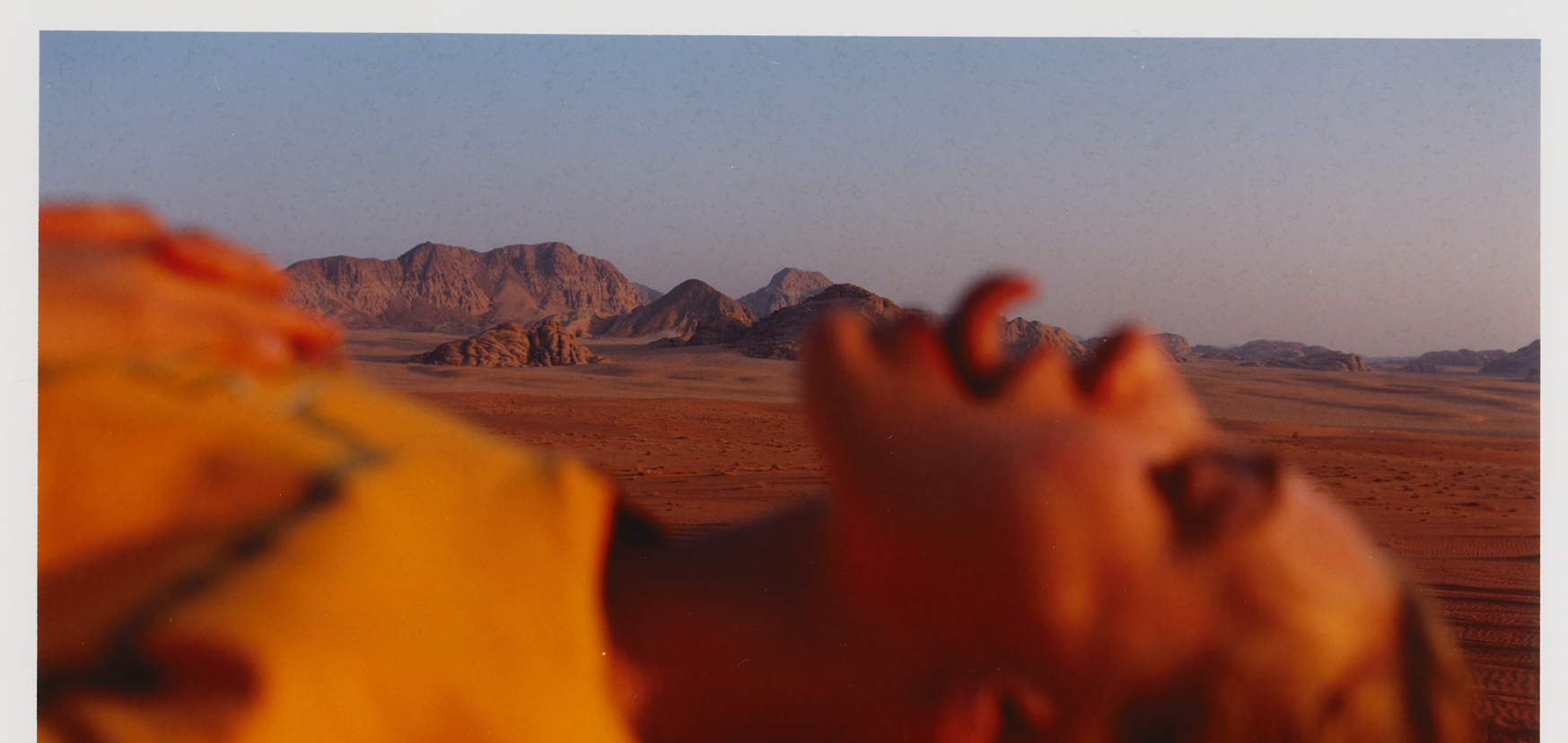

Hello guys,
Thanks in advance for your time.
I'm having a bit of trouble with my colour dark room at the moment, it's producing a lot of small dots in the highlights. They're on varied size and only seem to pop up on 50% of my negs. It's not a neg issue as I've had them scanned and looked very closely and it's definitely not coming from the neg. I'm using new Kodak Endura Gloss w/ Fresh Ektachrome chemicals. In a RCP20. It doesn't seem to be prevalent when I use Fuji stock. Unfortunately I much prefer to use the Kodak stock & seeing as I just invested into a new roll I'd like to stay on this for a while.
Has anyone seen this before, or recognises the issue?
Ref:

It's definitely not the negs, they've been scanned and have no signs of any of this dirt and it's definitely not the paper, bought new from B&H.
Clarifying that it's Endura paper with Ektacheome chemistry yes.

Cross processed Endura paper does show mottling. It is an endemic problem with all reversal papers and depends on the coated chemistry and the process chemistry. RA4 is not intended for reversal processing and thus does not have the "fix" present that prevents this mottle. It comes and goes.

I suppose what you really mean is "Ektacolor". Ektachrome is another thing...
I see the spots also in other regions of the print, in the yellow t-shirt for example. How about dirty rolls in your RCP20?
The rollers are super clean. This doesn't happen when I print on the Fuji stock, only the Endura?

The "FIX" is done in coating. I have done the best I can with reversal processed RA4 materials. To start with, I do not recommend using E6 chemistry as that is not intended for RA4 type emulsions. I suggest milder, paper type, developers such as Dektol and using the RA4 developer for the color part of the process. If you search, you will find that there is much posted on this type of process, here and on Photo Net.

Hello PE,
I don't think I'm using E6 chemicals, It's c-41 paper chemicals, I may have typed Ektachrome when I meant Ektacolor.
Is there something that looks out of place in my recipe:
Dev Replenish:
2L water
125ml A
50ml B
125ml C
200ml water
To make 2.5L of Dev replenish
Dev:
1750ml of dev replenish
62.5ml starter
687.5ml water
to make 2.5L of DEV
Blix
1400ml water
500ml A
500ml B
100ml water
To make 2.5L BLIX
All water is between 21-35 degrees when mixing and I stir for 1.5 mins before adding each element.

Normally working solutions are also replenishers in RA-4, so it seems strange to me that you dilute differently in the case of CD. What kind of Ekatcolor chemicals are you using?
Ektacolor --> RA-4
Flexicolor --> C-41
ektacolor for ra4

Only the RT type needs starter, but there is also differences in the dilutions you are using.
For 2,5 liters of developer working solution you are using 87.5 ml A + 35 ml B + 87.5 ml B
According to Kodak instructions you should use 100 ml A + 44.5 B + 100 ml B. This same solutions is also replenisher.
There also divergences in the Blix (355 ml A + 500 ml B).
What instructions are you following?
