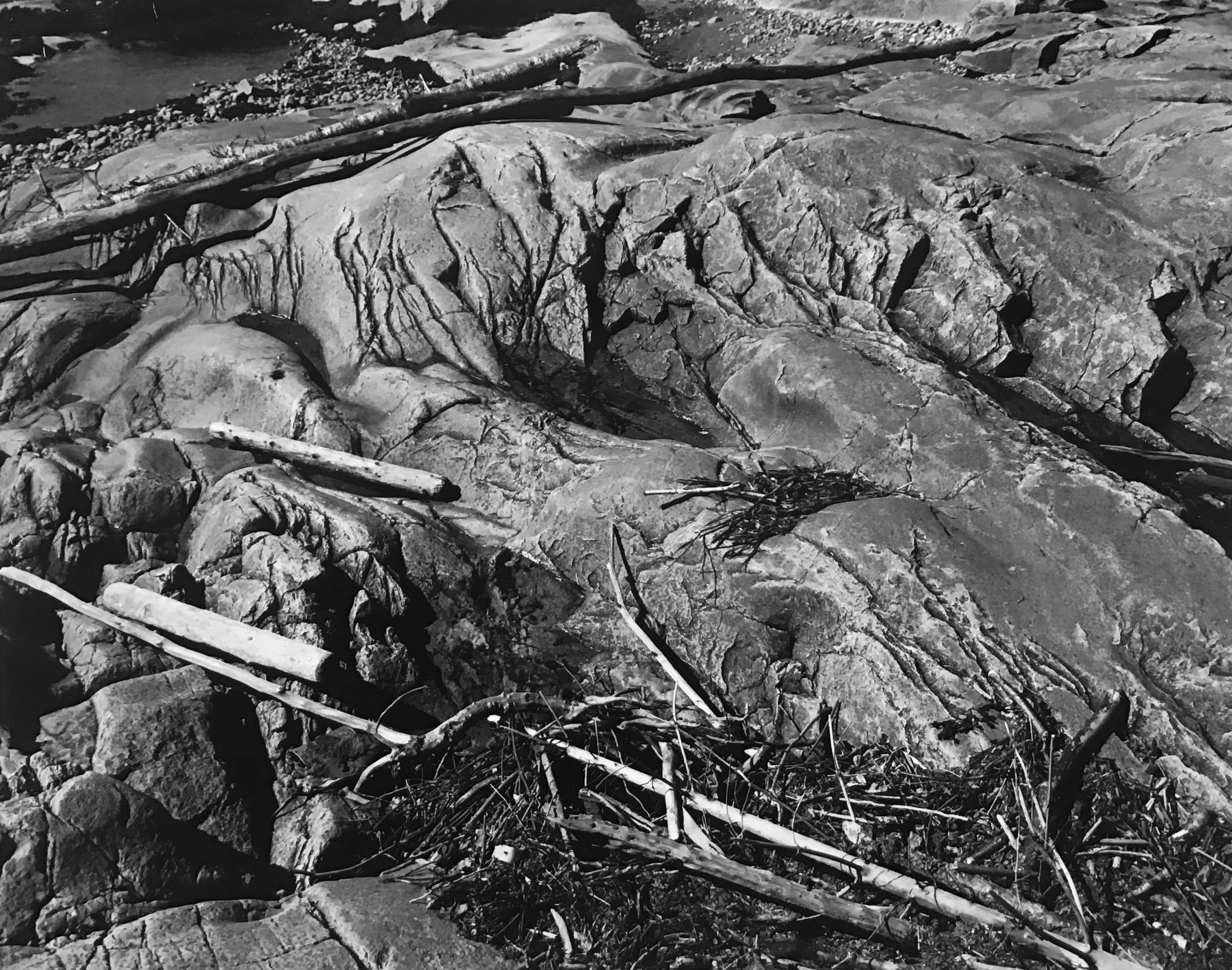

Don't use DK-50 outside the studio, they said...
Michel Hardy-Vallée
Membership Council
Apr 2, 2005
4,794
Montréal, QC
... because it's not really a good developer to cope with the great outdoors!
I'm kidding a little bit, of course because this kind of outdoors scene actually does not have a large subject brightness range, and is in a way equivalent to a portrait lighting setup.
In other words, as long as you know the kind of light you're working with, what your developer does to your film, and what you want, everything can work.
DK-50 1:1 on HP5+, Rapid-Omega 58mm. Les Escoumins (Québec).

Nice. Anchell and Troop praise it for having excellent gradation. It seemed to me they implied the gradation is a reason to use it instead of typical MQ developers like D-76 despite its more limited ability to cope with wide dynamic ranges. Maybe it's a bit vague what gradation is. Do you have any observations about this?

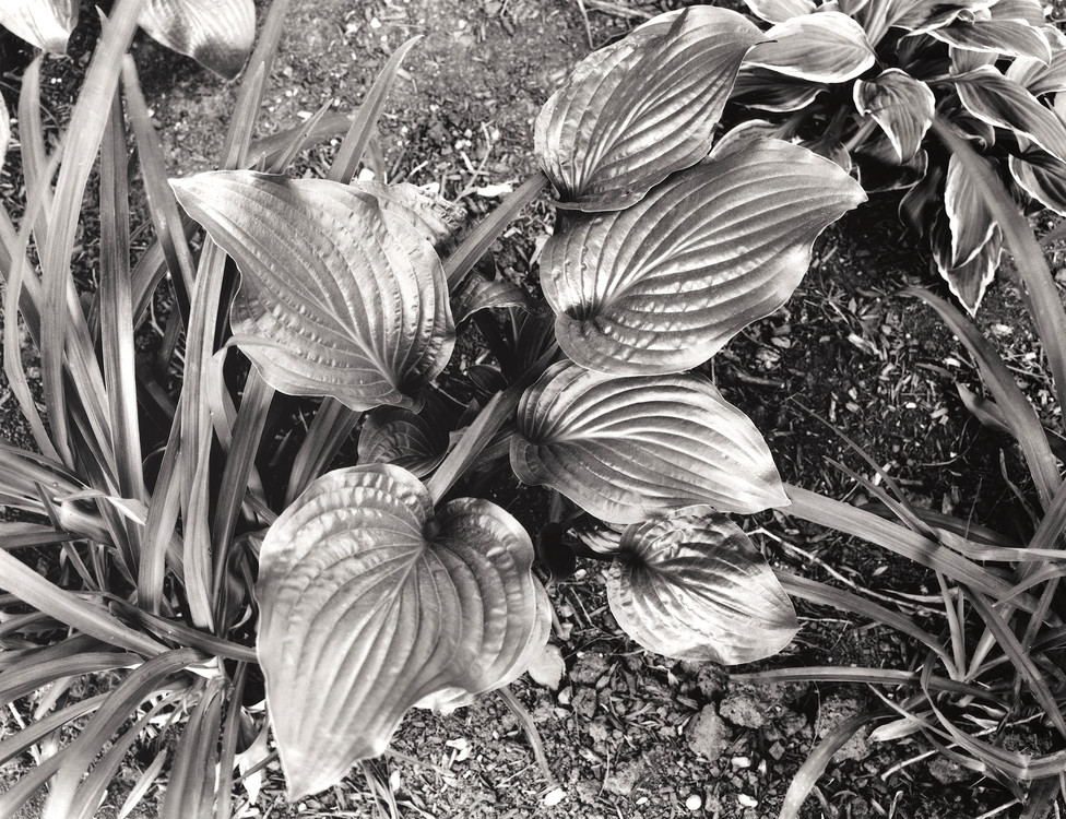

In the right dilution and agitation model, DK-50 is capable of spectacular results ...
