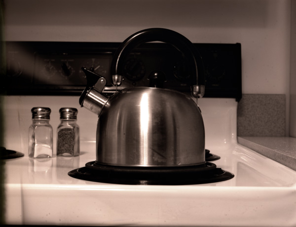

Earlier this year I couldn't resist trying caffeinol for laughs. It actually works. Do Google, there are tons of places that describe various methods. Here's 4x5 I took while experimenting. Oh, I did use a standard fixer. I'm not aware of any household substitute.
