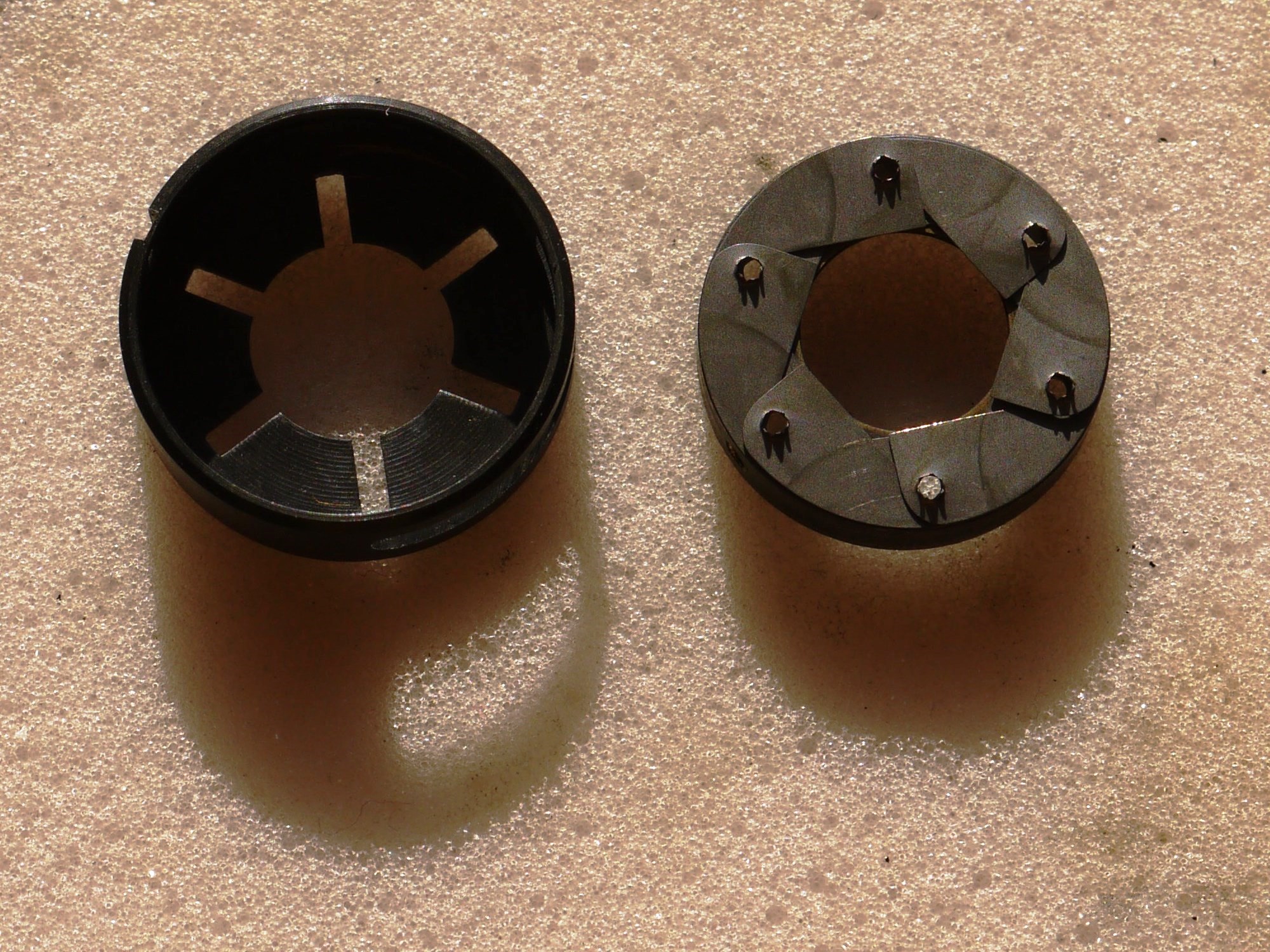

Having my first varifocal lens disassembled before me, a Pan-Cinor 8 through 40, I am entering the subject.
This lens consist of three distinct parts, the basic image forming (strong positive power) part, the middle afocal, and the front focusing part which consists of a cemented doublet or achromat. True zoom lenses have mechanical or optical compensation for a number of geometrical things that change upon shifting the afocal elements. I should say that zoom lenses that stay in focus are complicated and therefore expensive products. Everything else is amateur gear.
That Pan-Cinor also has second best iris mechanics.
