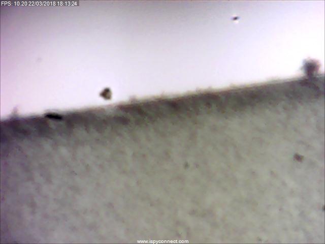

If a process is analogue all the way but some digital gear was used in an advisory capacity, is it still analogue?

I couldn't find the incandescent bulb for my Zenith enlarger so used a 10w household led one instead.
Mechanical timer for a focusing aid? :smile:
graincam is the name I gave to the pic so I could find it easier on my cluttered desktop.
It's a £2 webcam I ordered from China. Removed the lenses and put the lens housing back as a hood. Gives a better image than I thought it would. Pic is of the edge of the film/perforation.
Next step is to mount it onto something flat.
Will the absence of an IR filter matter much wrt focus?

Assuming it is good enough to be useful, I was thinking of having the sensor mounted on a board so it sits at the same height as easel + paper. Focus, move sensor out of the way, move easel where it needs to be.

A easy to use grain focuser for old guys like me ? I love it! Genius ! So if I understand, you have a small WiFi camera focused on the projected image, you view this on a phone or tablet for critical focusing?
If I could stand up straight with a phone in my hand to focus my 8x10 enlarger that would be cool. Patent it :smile:

Wired, not wifi.
It's a de-lensed webcam. Light from the enlarger shines on the sensor and the image is displayed on my laptop.
My original idea was for a tablet or smartphone that has a front facing camera but even the 'mostly dead' ones were going for over 20 quid. Didn't want to spend that much on something I'd be taking apart and de-lensing as I have a talent for turning mostly dead kit into extremely dead kit.
Now that the concept has been proven, (One crappy image. HA!) I might spring for a mostly dead smartphone/tablet and see how de-lensing it goes.

Take a tiny camera and drill a hole in the easel mount it. It's worth playing with however you attempt. I use toy IR goggles to work in total darkness . If that's cheating so be it. Someday I will probably be using a cane to get around my darkroom . Any thing that aids the analog process I'm in favor of !
