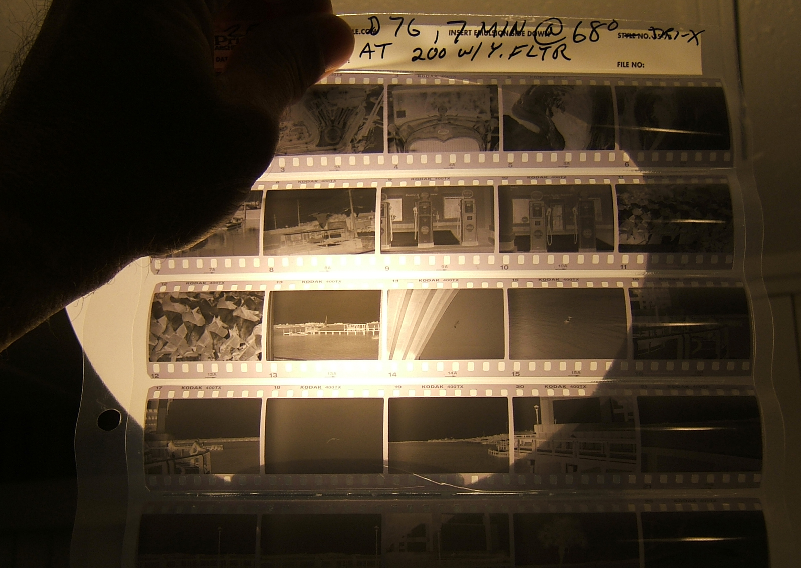

I have this Zenit 11 (unfortunately) and I thought it had a light leak, so I taped everything up on the back and sides and shot another roll. Looks exactly the same as before. Is this a shutter issue or a light leak? It is not there all the time.
The Zenit 11 has a horizontally travelling shutter. These stripes on the film are horizontal and unexposed. A light leak would result in exposed or fogged areas, the shutter should make a vertical defect when malfunctioning. Look at your processing and handling.
Take a peek here at the segment where it mentions "banding", irregular shutter travel. I think a similar trouble exists with your shutter at present.

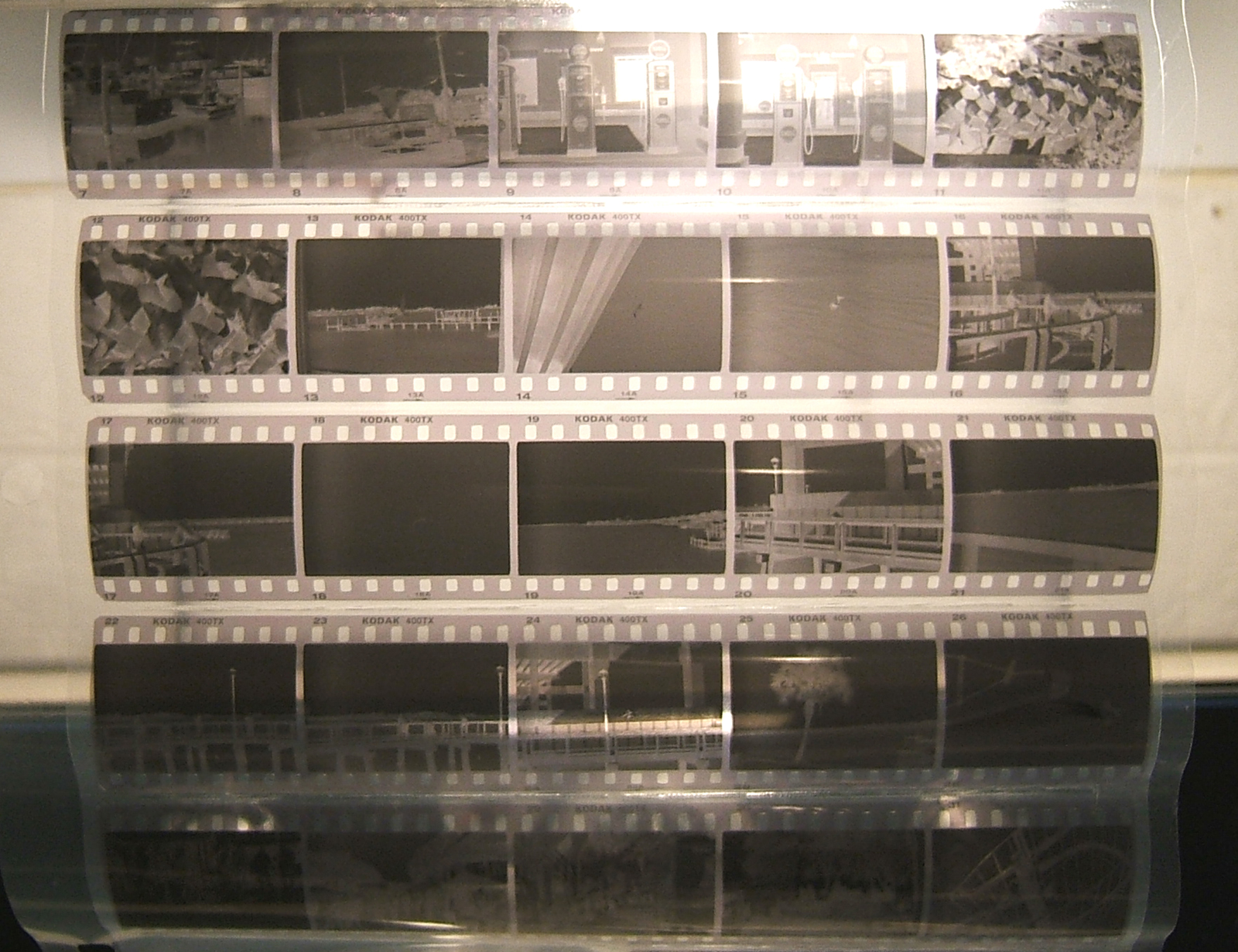

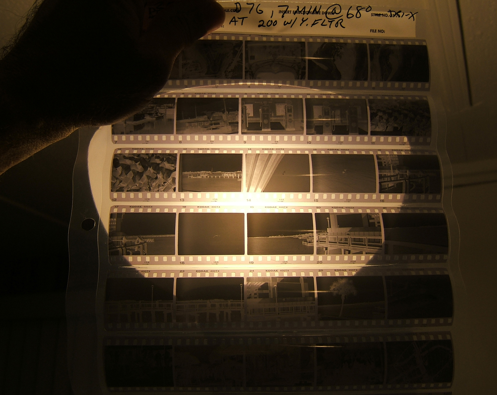

Every 5th frame, crosses the boundary between frames, height in frame not consistent, bright area on negative means unexposed area not overexposed.
Not a light leak. Light leaks lead to overexposed area not unexposed.
Not a shutter problem. Shutter will only affect in frame image, not the boundary between frames.
Since the mark is clearly visible in the boundary, that could point to something taking the emulsion off the film in that area. That would lead me to look for something physically scratching the film or a weird processing problem.
Hmm! I must be missing something here or my monitor is faulty 'cause I'm having a very hard time seeing this inclusion into the boundary area as you say. I see the light vertical strip to the left in the frame, but that's all I can see. Let me know where this light strip leaves the frame. Shutter bounce can sometimes lead to lighter areas in a negative and is also varying with certain shutter speeds.
That's a specular highlight glinting off the plastic film sleeve due to tri-x's curl, not a lack of density in the film.
Could you please explain exactly what the problem is? It's difficult to tell from the photos with the uneven background light.
Look at the denser negatives in shot one and two and you'll notice a light vertical strip running up and down the left side of the negative. I believe a scan would have been better, but it can be seen in these shots anyway.
