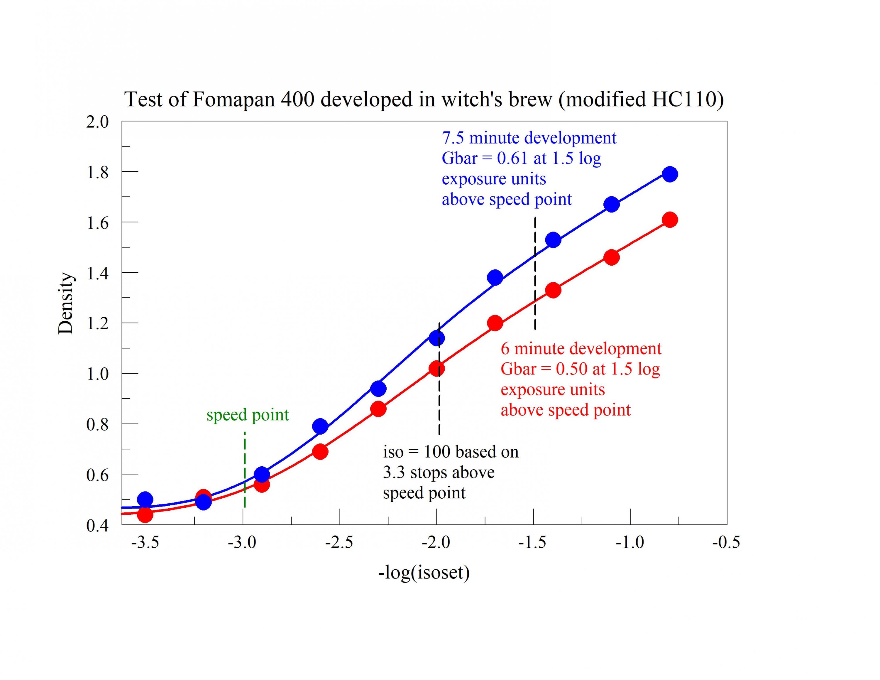

I may have answered part of my question, at least for a special case. Last night I did some testing on Fomapan 400 using my witch's brew of modified HC110 (1 part HC110 syrup, 2 parts common 5% white vinegar, 13 parts of water.) Using my densitometer, I found a film speed of 100, which is two stops below box speed. Rumor has it that the true film speed of Fomapan 400 is closer to 200, i.e. one stop below box speed, but in this case I was getting two stops below box speed, so it is suggestive that, at least for this film, lowering the pH of the developer ended up lowering the film speed by an unexpectedly large amount. (However, I did not make the comparison to Fomapan 400 in other developers, so my conclusions are tentative.)
By the way, when I did a similar test with Fomapan 100 (using the HC110 witch's brew mentioned above) I was getting about 1 stop below box speed (or maybe 2/3 stop below box speed), so perhaps the witch's brew developer is particularly ill-suited to Fomapan 400, at least as far as film speed is concerned.
With matched contrast??
Yes.
Here's a graph of the results. The upper line is comparable contrast to the Fomapan 100 test results.
Note: The speed point for the two development times was virtually the same, so I am only showing one on this figure.
Is that 0.50 vs 0.61?? That is quite a mismatch if I read it right.
PE
Yes, the two curves had different Gbar, 0.61 for the upper curve and 0.50 for the lower curve. The best development time could be could be half way between (6 minutes 45 seconds) which would give a gbar of about 0.55.
By the way, the contrast for the upper curve (0.61) is pretty close to the way iso defines their test procedure, which (as you know) is based on the slope between the speed point and a point on the curve that is 1.3 log_base_10 exposure units more exposure.
By the way, I am not sure what is the "official" difference between the speed point and the zone V metering point. I have recently been assuming that 3.3 log_base_10 exposure units is about right. I believe the zone system aficionados like to use 4 log exposure units, but in regard to this I have heard that the zone system folks like to use denser negatives than many other people do

3 1/3 or 4 aren’t log_base_10 exposure units in that context. That’s a count of f/stops. An f/stop is 0.3 log_base_10, each third-stop is 0.1 log_base _10 so the speed point to metered gray is 1.0 log_base_10 in standard model and in Zone System it’s four stops which is 1.2 log_base_10
The 0.2 difference is an interesting difference between the two methods.
You are right. As you correctly say, 3.3 f/stops is about 1 log base 10 unit. I may be communicated poorly on this. My graph refers to 3.3 stops difference (which is correctly described), but my later post incorrectly identified this difference as 3.3 log base 10 units, which is incorrect. Thanks for catching this.
