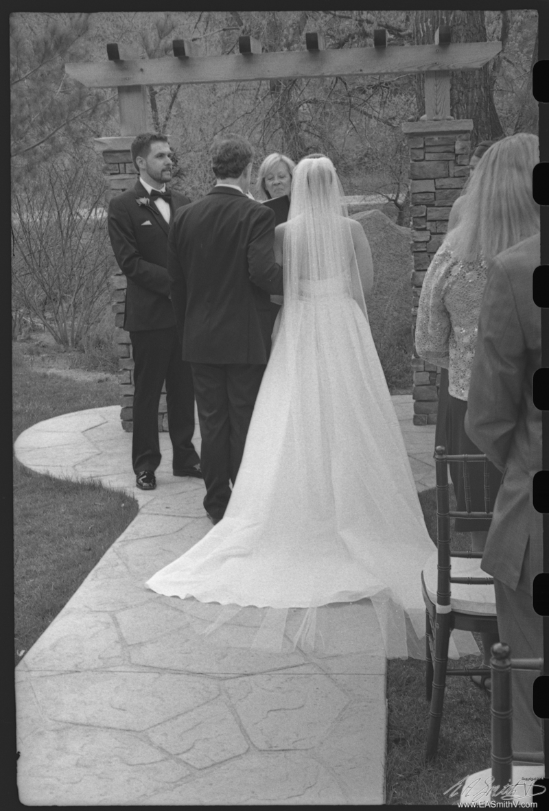

Seems like most rolls i shoot turn out like the attached photo, sprocket holes as part of the image. it's kind of annoying as i lose image area. Is it me, do I need a CLA, or is it a loading error?
Annoying, because it will look off with my filed carrier.
This was shot with a Barnack (IIIA)

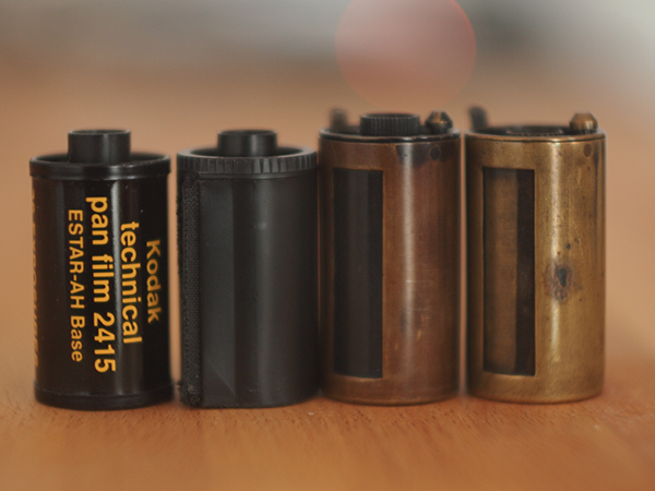

It is not a mistake at all, it is simply the fact that Barnack bodies were designed around Leitz cartridges which are not exactly the same size (shorter) as those from today film manufacturers. The washer to offset the size difference as explained above is the way to go.
The Barnacks were designed before the DIN for cassettes the DIN is 2mm shorter than the Leics FILCA.
The IIF and IIIF (and laster) had a enhanced base place to avoid the problem but still accept FILCA,
The M are to the DIN, so dont accept FILCA, needing IXMOO.

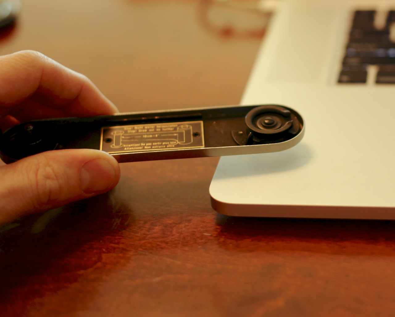

can ii mod my baseplate for proper function?
Not like the factory they milled the chassis to accept a prong on the baseplate.
A plastic spacer push fit into base plate latch should be ok or similar bodge
Somewhere I saw a quick mod, removing a screw and flipping a piece over. I can't find the thread anymore and don't know if it works.

I see a desperate need for visual clues in this thread.
So, here we go..
attachment.php
What the OP noticed is quite normal for Barnacks and some derivatives up to ~ WWII.
If you alter your body, then you are stuck with the “modern” cartridges, whether they are shorter or longer than FILCA, well, u see...
Some folks use washers, other just don't push the take-up spool to the very bottom of the body, I frankly don't care and just shoot away.

Up to '52 or so, and a late IIIf will still accept FILCA, the baseplate change does not push the cassette but the film.
