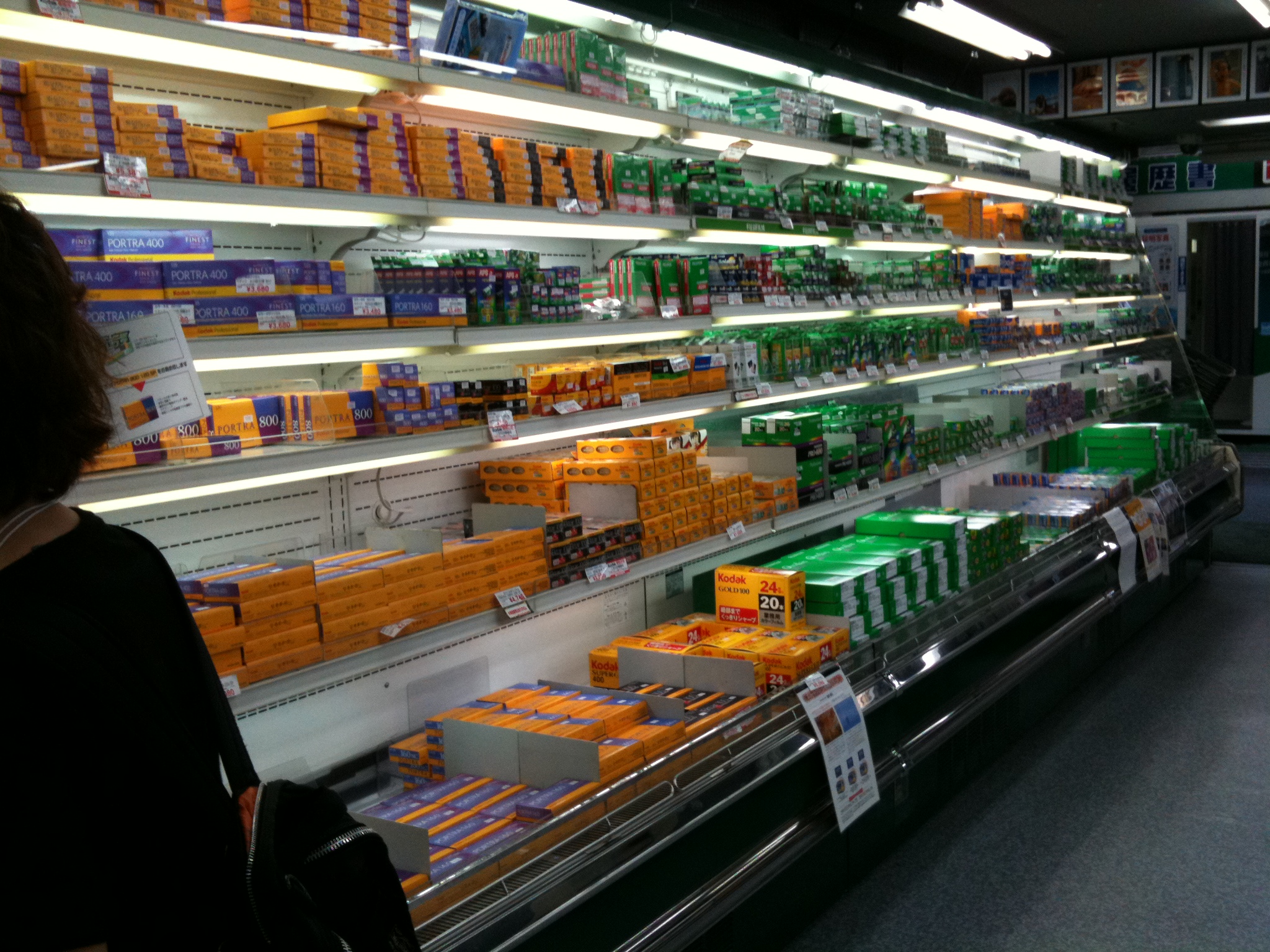

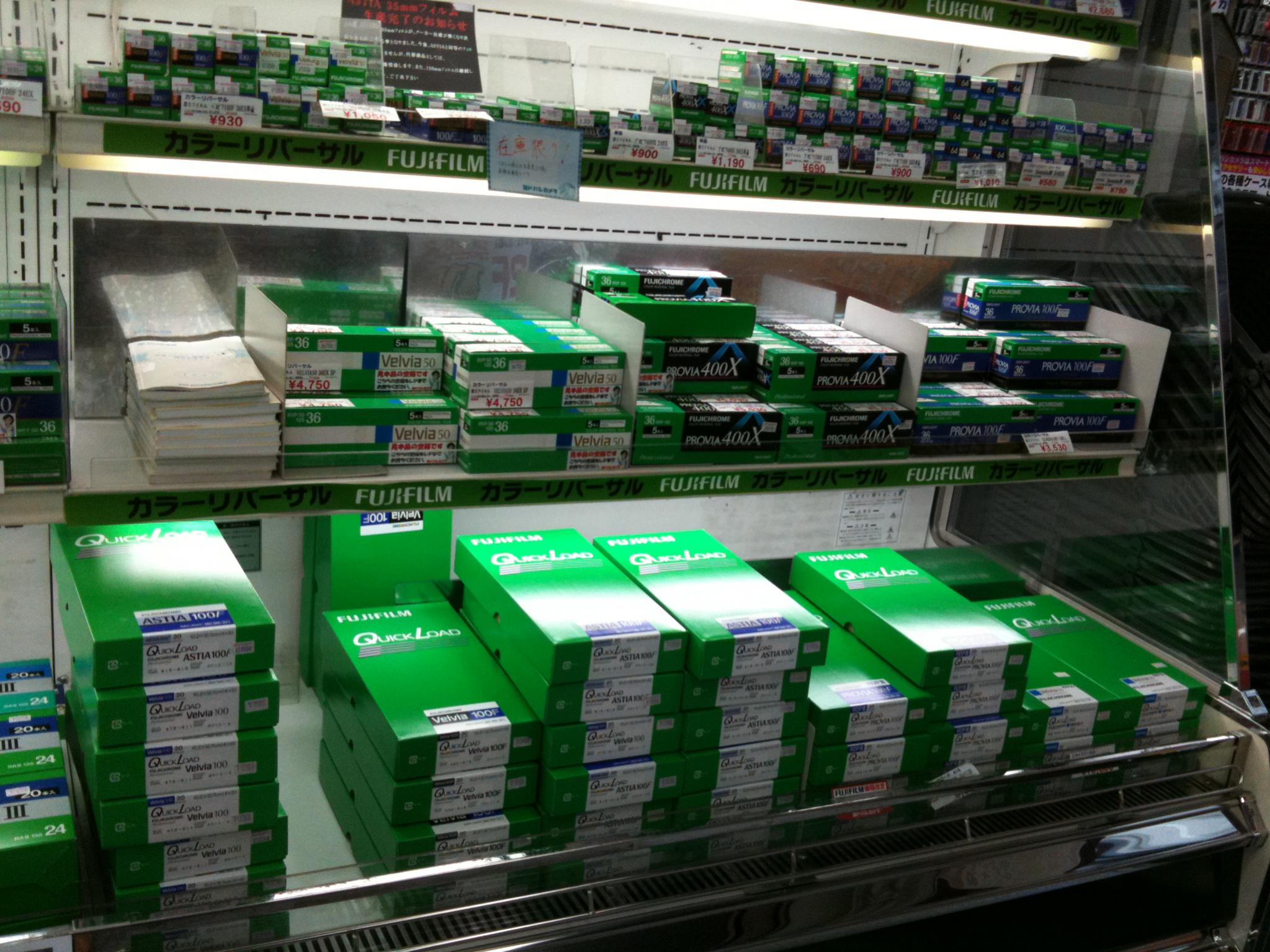

I don't know if people are being serious or not, but as for being a supplier myself...besides the logistics, I don't live in a big city like Tokyo, Osaka, Nagoya, etc. where I can purchase these products. As it is, I stock up on chemicals and paper the few times a year I make it to Tokyo or Fukuoka or similar cities that have a Yodobashi or Bic Camera store in town.
We don't have anything like this in Kumamoto:
I know it's film, but I don't have any photos of the paper section, which is in another building. These photos were taken at the mecca of photography, Yodobashi Camera in Shinjuku, Tokyo last summer. Now it's only a single wall cooler full of film, but as little as three years ago there were at least 3 big coolers in the same location: click. The film section (now) is a little decimated but the paper section (starts at photo 16/40 with the Fuji paper) is still pretty accurate.

Those pictures make me drool....VERY MUCH!
