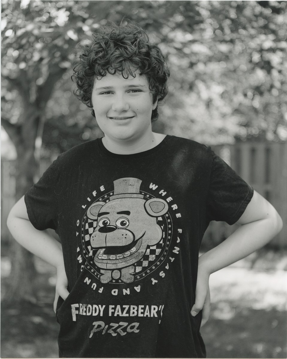

Here's a print I made last night of a friend's son. I plan to give it to his parents when I see them this weekend. It printed easily: I didn't find any areas I felt like needed dodging and burning, and I was able to find the right exposure with just two 4x5 pieces of paper. The whole thing took me about 15 minutes. It's not going to win me any awards, but I'm pretty satisfied with it, and I'm happy to share it.
This isn't the norm for me. There are prints I've spent hours and reams of paper on, dodging this and burning that. But for most things, I'm somewhere in the middle: four or five test sheets of paper of varying size, and dodging/burning that I can do with generic tools I have on hand -- black paper with different size holes, elliptical dodging tool, or even my hand.
Still, sometimes I wonder if I'm missing an opportunity to turn every ordinary print into something extraordinary.
Technical details: Ilford XP2 at 200, Yashica Mat 124G; Ilford MGIV RC 8x10 paper (pearl). Split grade print: 200M+0Y (32s) + 0M+200Y (10s).

It is an ok portrait. The light on his face is a little bit flat and he appears to be squinting as if he has not gotten used to the light. I think those are difficult to fix while printing.

since you have it scaned, try fiddeling with the lighting in photoshop to see if you may like more contrast or dodge n burn fixes?
Certainly squinting is. And yes, his hair is unkempt, he has cat hair all over him, and the T-shirt is overbearing. So "portrait" might be an ambitious term. But it was taken as is and in the moment. I think they'll like it for that reason.
Looking at it again, some low grade dodging of the face and arms might help the subject pop a bit. But this is based on my looking at the scan of the print, and I try not to make printing decision based on what I see on the screen.

BVY -- The skin tones will be important, of course, and being light in tone, they'll will be quite different on a print than what one sees on the screen. I like the way they are on my screen...light enough to pop him to the fore-front of the scene.
