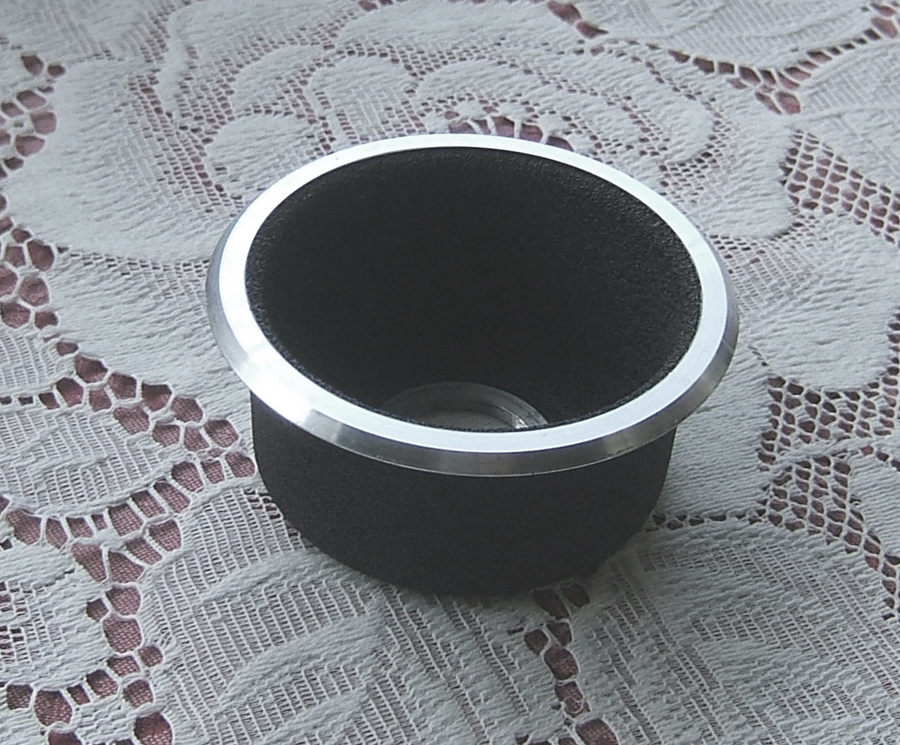

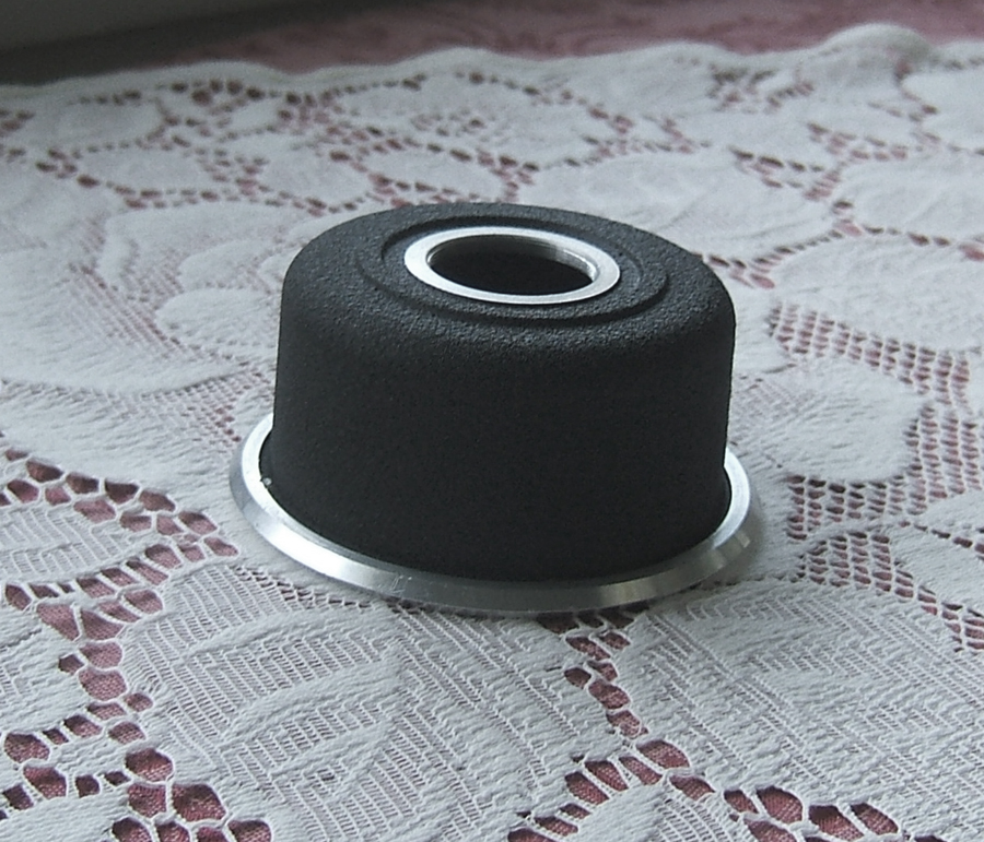

I bought a Durst 606 enlarger and it came w/ this recessed lens board (looks like 24mm threads for the lens). It's about 1 9/16" deep. I know Durst has a lot of fancy names for their lens boards, but I was wondering if this one would work for 6x6? I don't have a lens for it yet or I would just put the enlarger together and ck it.

Could be a Femotub (I think the LATUB is a recessed board) - Yours looks like a 25mm thread, so not too many lenses will fit. Whilst it may not be as useful for general use, it will be handy for doing small prints. I have one that I use with a 150mm lens when printing 6x4 or smaller (for postcards) from 5x4 negs.
Edit: Having looked at the posted images, either you have two different boards, or there is a double chamfer on it - If this is the case, then it can be used as a recessed board, or an extension. Most unusual if it is....

You're correct on both counts Paul. It appears to be closer to 25mm than 24mm, and the board does indeed go into the enlarger both ways. Very handy. I didn't see that. You have keen eyes. Not too happy about the thread size. I may drill it out so that I can put the more common 39mm lens like the Nikkors in it, w/ a lock nut to hold it in IF the thickness of the lens board allows that. Otherwise I'm going on a hunt for 25mm enlarging lenses. Have no idea what focal length to buy, as all I want to do is 6x6 (at least 11x14, or 11x11 w/o a crop), but the handy "flip" feature should help on that score. Maybe.
These old Dursts are good enlargers, but the lens boards can be frustrating, and they cost an arm and a leg if you need another board. Probably should have bought another old Omega B600 or C700, and not had these lens board issues.

Yes, I have a Durst 606. Not sure why I gave up using it, it's great machine.
The recessed mount or Ixotub is for 50mm lenses for 35 mm; mine is an Ixotub 39 to take 39mm mount lenses. The flat one is called Ixopla 39 for 6 x 6 negs; my machine came with a 90 mm lens but I imagine it is good for 75 - 90 mm lenses. As observed the flange is bevelled both ways, and is larger than usual Durst lens boards, which I have found can be made to fit by super-gluing short segments of match stick to the rim in appropriate places. I think that anything from Durst with a name beginning Ixo- is for the 606, though I could be wrong.
I have just come across an Ixotub hiding in my darkroom - If anyone is looking for info on these. the overall diameter of the flange is 81.25mm and 4.50mm thick, with a 45° bevel (90° inclusive). For comparison, a typical Lapla is 78mm diameter.
