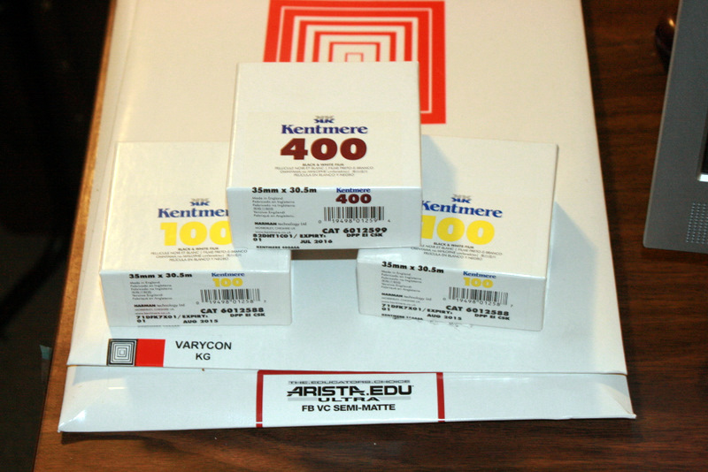

I am currently in the process of testing Kentmere film for my self. I was very happy with the 100 film for processing and printing. I just love the evenness of the prints. It is definitely going to be a favorite until the price sky rockets or the quit making it which seems to be the case for a lot of my "favorites". So I ordered more + the 400. I will be using ID-11 1-1 or Rodinal developers :D :cool:
