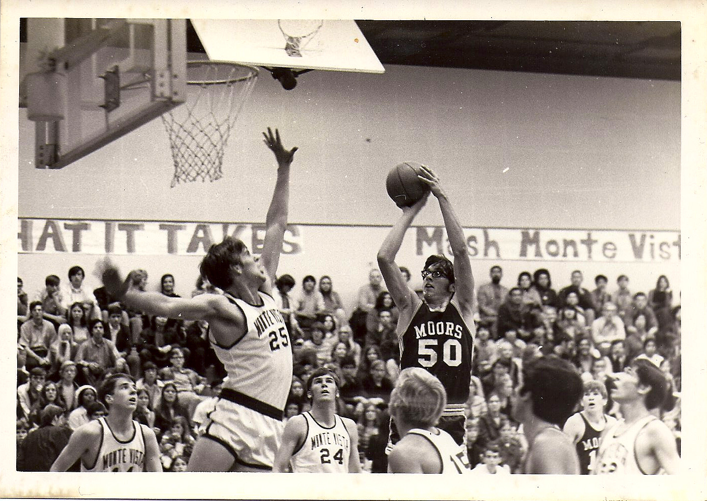

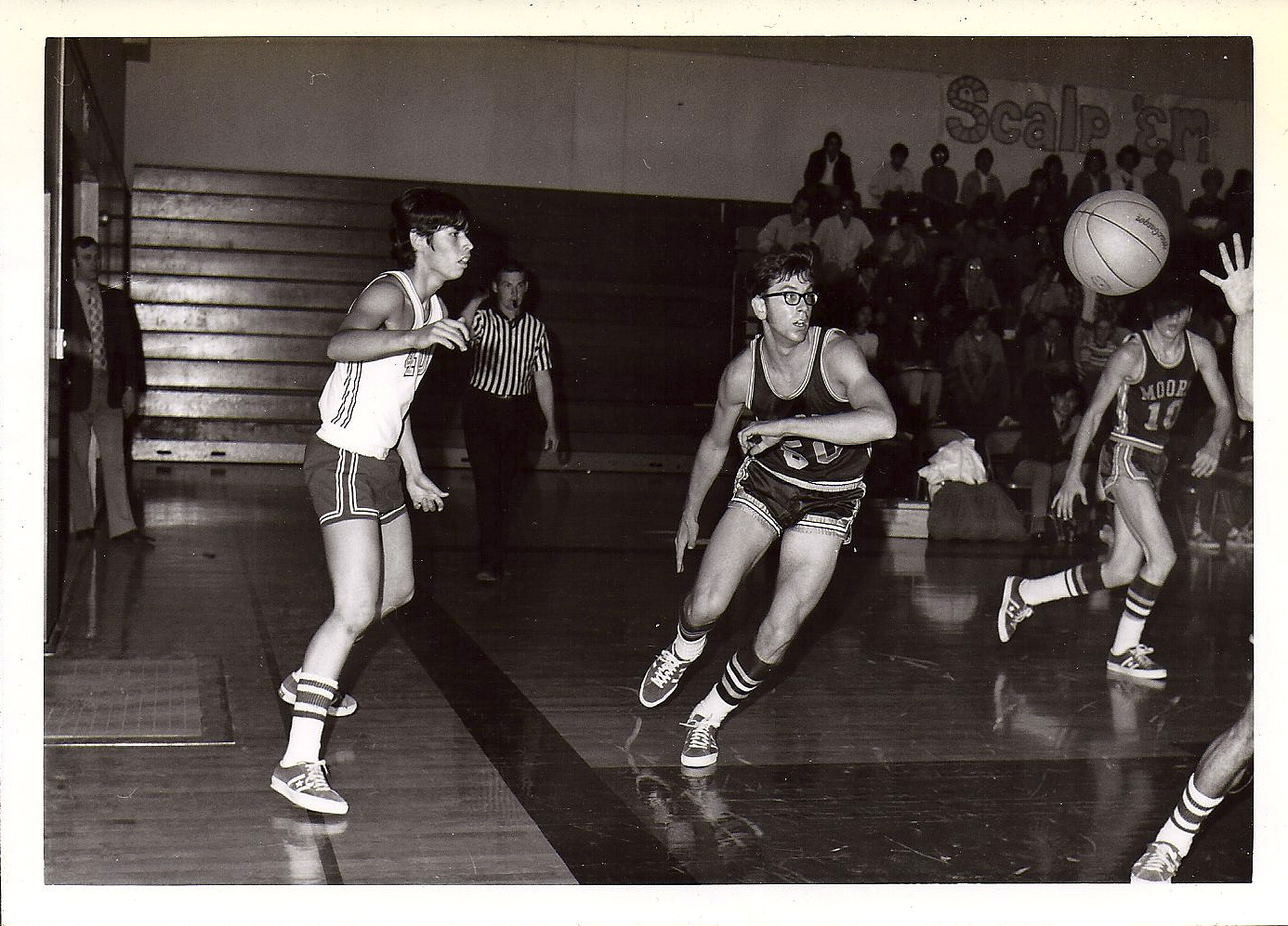

Vaughn
Dec 13, 2006
10,079
Humboldt Co.
Close as I can get...A couple photos of me playing basketball in the very early 70's. Taken with a Rolleiflex.

If you are a true master, you can follow action in a TLR's WLF without resorting to the sports finder:smile::wink:
Alan Gales
Oct 16, 2009
3,253
St. Louis, M
Back in the days of short shorts, long socks and Converse high tops.
Nice shots and nicer memories, Vaughn!
I still wear the Converse high tops! :smile:
