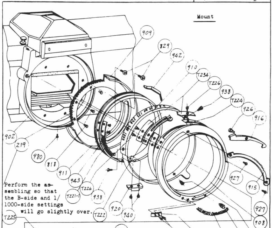

As for the "B" setting being blocked, in looking over the repair manual, it is possible the shutter speed selector ring was placed back on the body slightly out of position and the gearing is running out before the rotation gear can activate the "B" setting.
The attached screen shot of the manual suggests the gearing has to be carefully centered. Maybe your copy was serviced and the ring not returned to the proper position?

At this time, no, but I wanted to know if this was common. I thought there might be a fix involving minor disassembly that I was competent to do. But at this point no one seems to have had direct experience with this. I like the theory that the gearing may be a little out of position advanced by @Kino et all, but that doesn't explain how the slow speeds fire correctly when selected normally--i.e., with the number centered in the viewfinder and on the ring.
