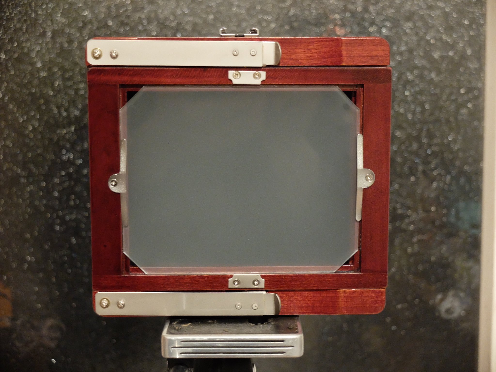

I would like to tell you a bit about the Nagaoka pinhole camera for 4x5.
I got it today and it is a very special piece. It uses the usual sheet film cassettes, but a slide-in type Cambo roll film holder or the Wista roll film holder for slide-in also work perfectly.

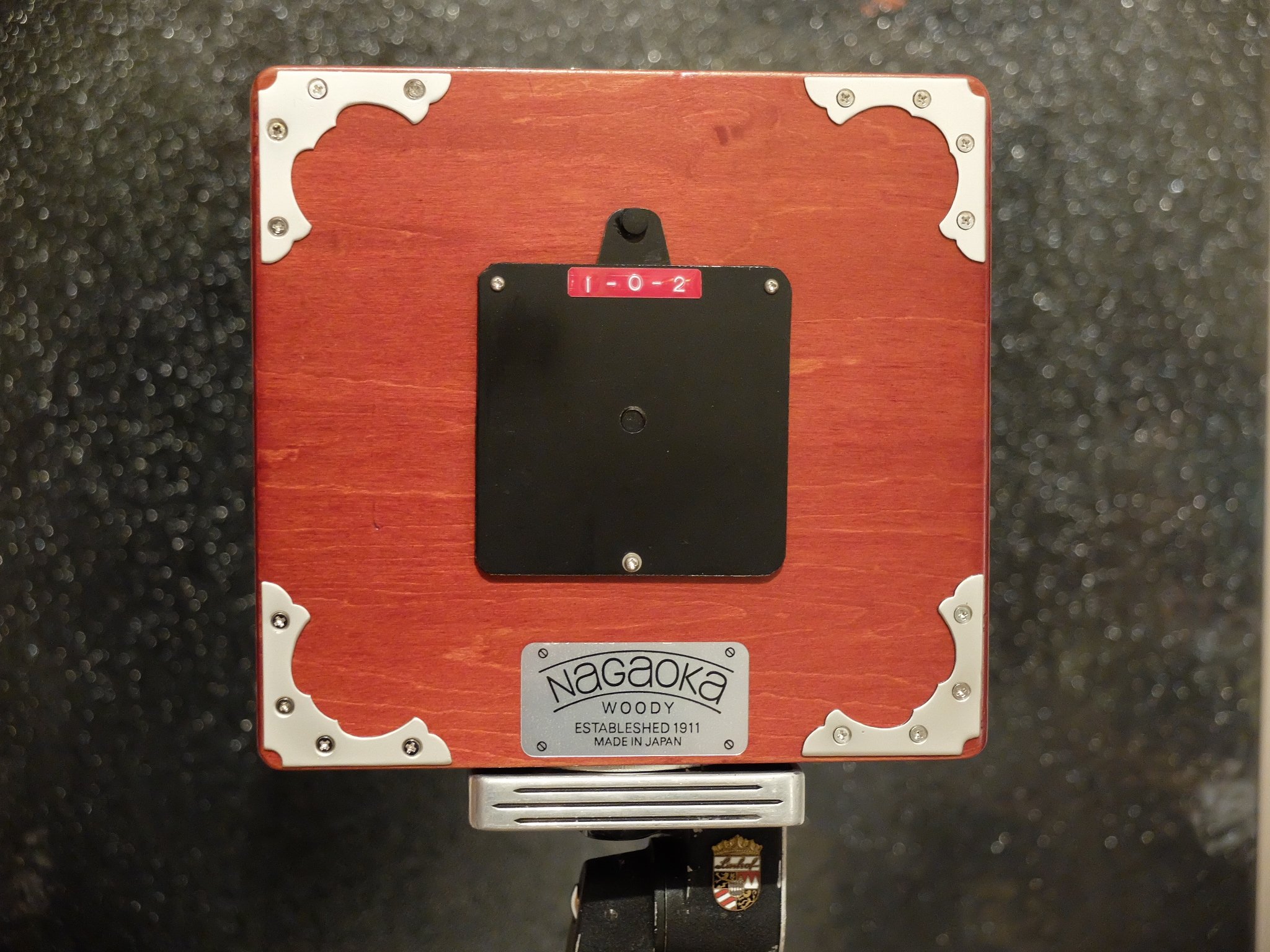

The camera has a "focal length" of 65-70 mm and is therefore not super wide but wide enough. There is a slider on the front that has three positions: Closed (position 0), 0.3 mm hole (position 1) and 2 mm hole (position 2). With the 2 mm hole, the image can still be seen on the ground glass using a dark cloth. I am now looking forward to the pictures.

If it has a focal length of 65mm and apertures diameters of 2mm and 0.3mm you dived the focal length by the aperture diameter.
So the 2mm ones gives you a 65mm f/32 .
And the 0.3mm pinhole would be f/216 in round figures .
If the focal length is 70mm , just redo the maths . 70÷0.3 = F/233 .

With a dark cloth and the 2mm hole, the ground glass image is still bright enough to see what will be on the final image. However, you must use the smaller hole to take photos, otherwise the photos will be much too soft and dark at the edges of the image.
Do you also have a Nagaoka? Pinhole photography really isn't rocket science. The camera can be used wonderfully even without the focusing screen. Pinhole photography should be one thing above all: fun.
