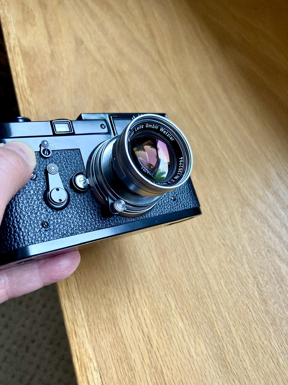

I am thinking of selling my mint 11116 which has an interesting ownership history and a M-Hex 50/2. I want to replace the two with a 11817. I’ve owned the 11116 for 20 years. It came from a LHS Col Moss estate.
