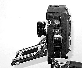

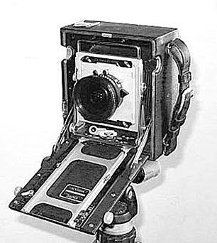

Dropping the bed on a Graphic looks like this:
attachment.php
attachment.php

now I know what is ment: I have to lower the front bed - however the lens remains in the rear bed. The front bed is lowered because of the wider angle not to interfere with the picture I want to take.
Thanks a lot for this explanation!
Jan-Peter
