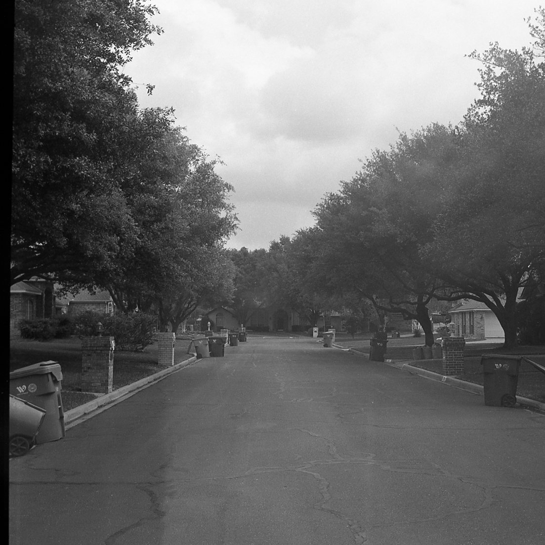

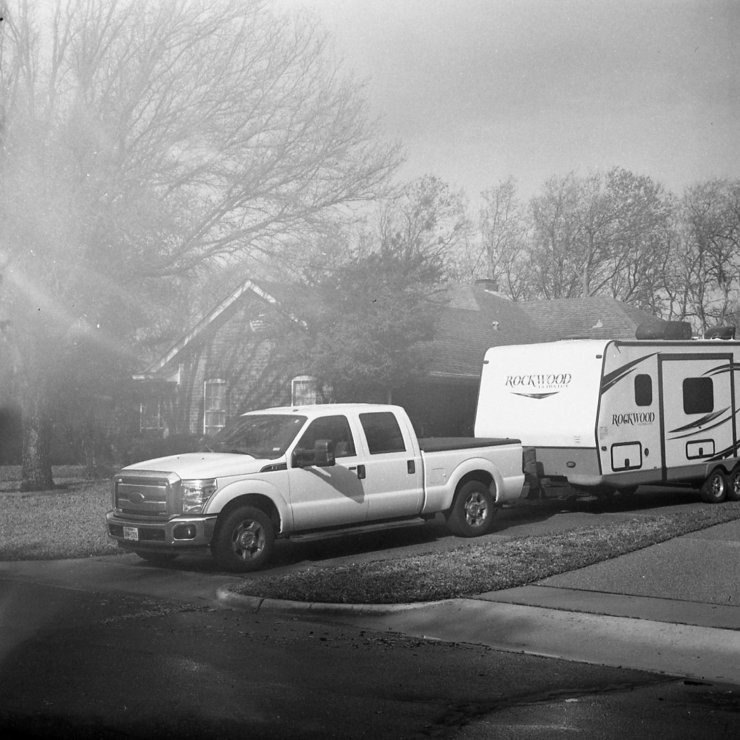

The first roll showed me this was pretty much DOA from eBay, probably bellows pinholes, and I could see a couple later. Examples: 2022-04-05 ... 001 and 004 below.

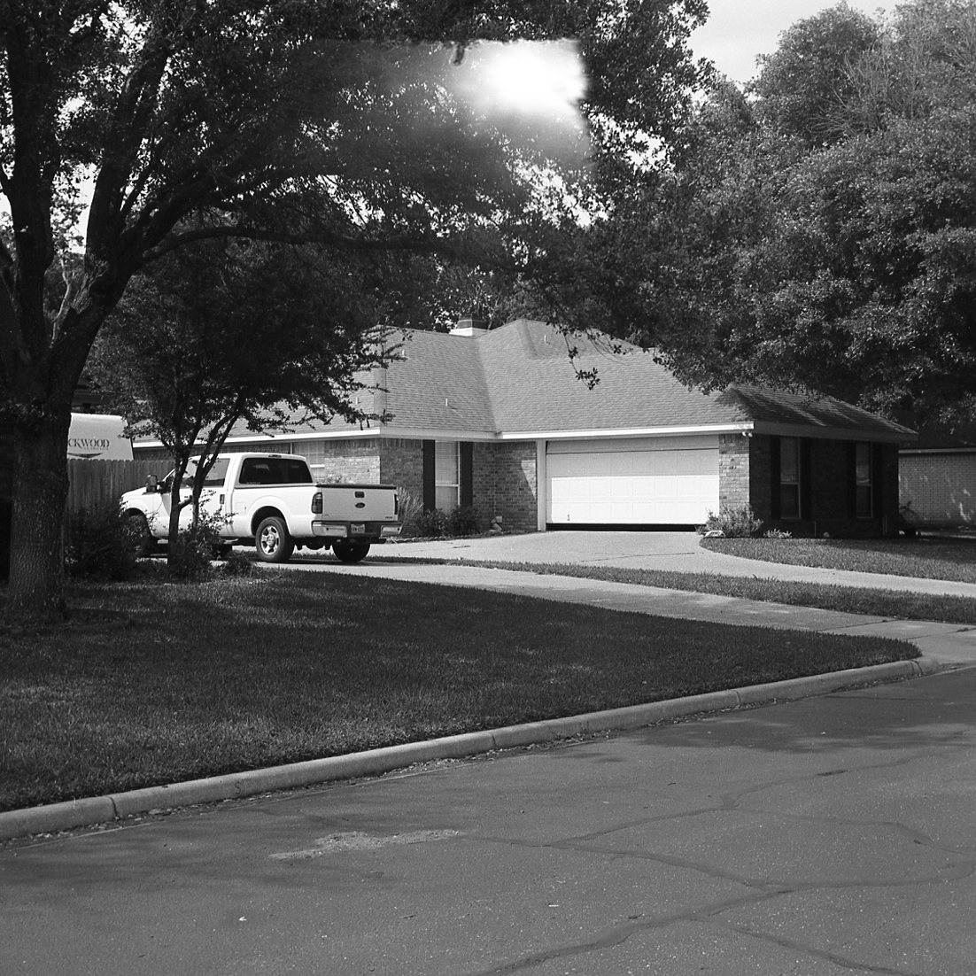

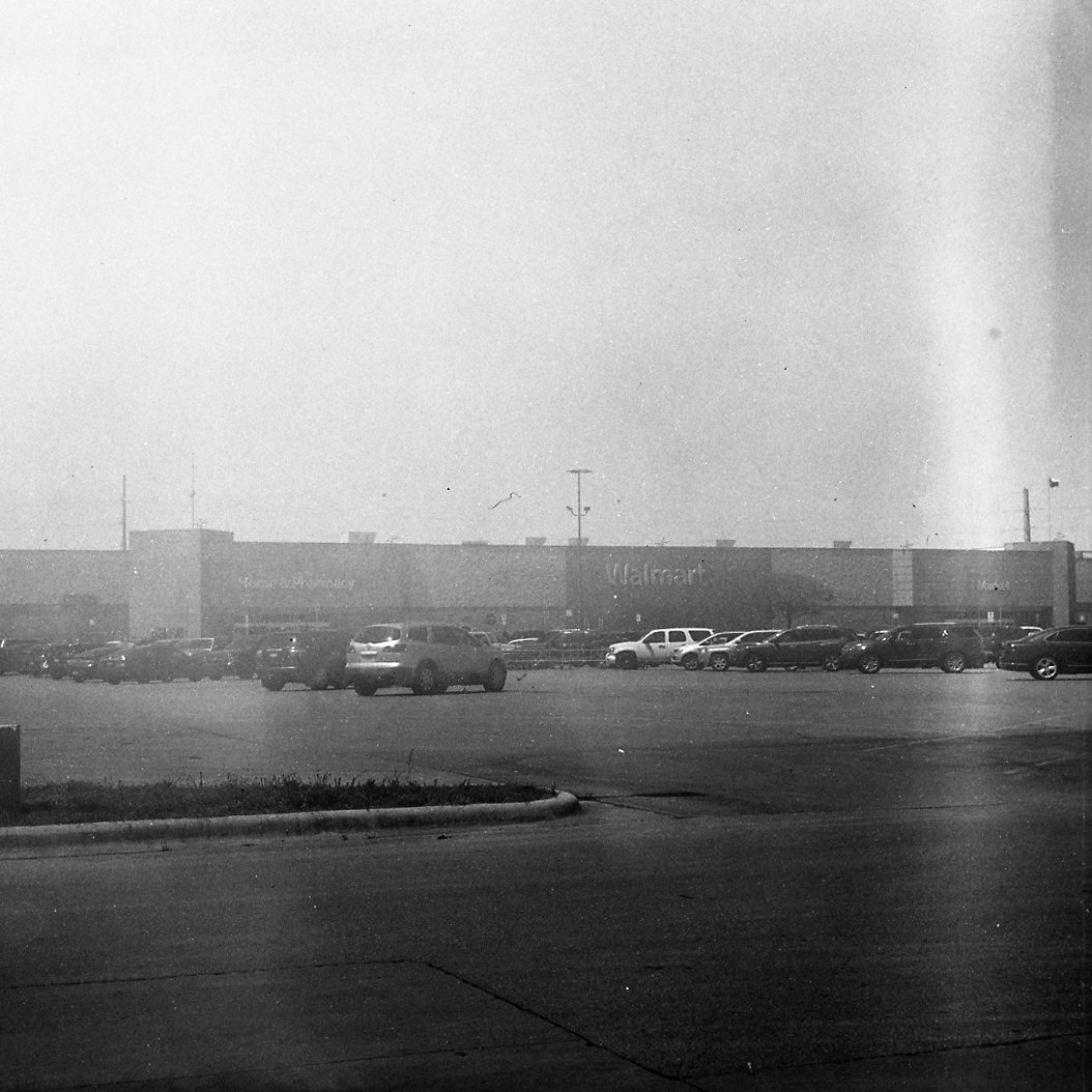

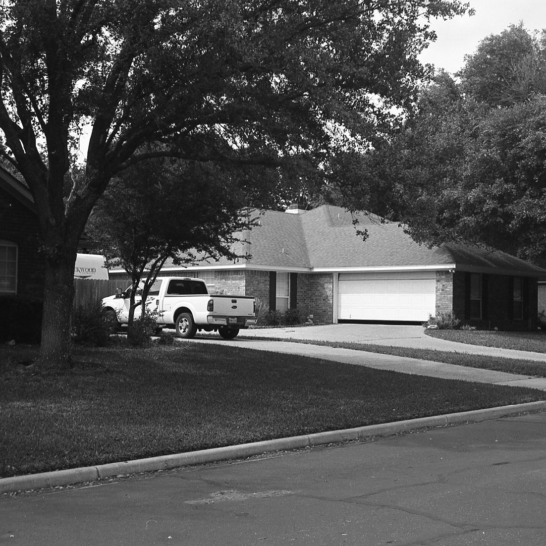

For the second roll I wrapped the bellows with a dark cloth and got 2022-05-22 010 below. Took off the cloth and got 2022-04-22 005 and 007 below.
I think 007 shows I still have a pinhole somewhere, although it is so much brighter and sharper than the first roll leaks I thought I would ask you folks if it looks like something more than a pinhole.
I think 005 shows a light seal leak, probably where the back latches. In other words, something different than a bellows pinhole, since it is so vertically uniform. Does anyone agree that it is a light seal leak?

You didn't ask my opinion on terms, but IMO "dead on arrival" means the camera doesn't operate, like stuck shutter, focus seized, etc. Bellows pinholes are a frequent problem with folding cameras, and like many light leaks require repair before the camera can be useful, but not "DOA."
The straight edge to the light struck area in 005 and 007 might be from a light leak that is partly shaded by a fold of the bellows. I wouldn't yet judge that 005 has anything to do with the back.
Common advice for finding bellows light leaks is to take the camera into a dark room, open the back, and put a flashlight or light source inside the bellows from the back. Clearly the professional way to fix them is replacement, but you can also try liquid electrical tape or similar concoctions to patch small leaks. If you do that, search for others' recommendations (small amounts in multiple coats, don't goop a lot on, etc etc).
