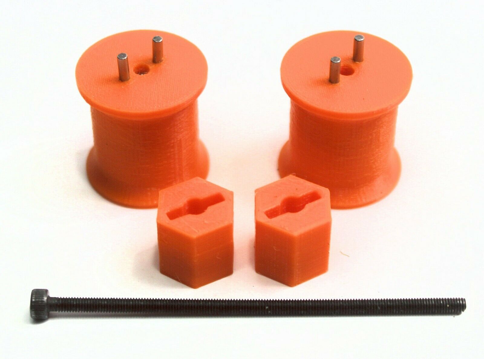

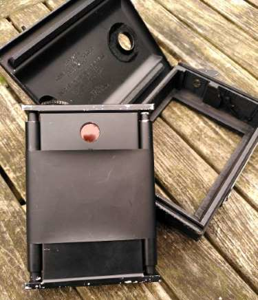

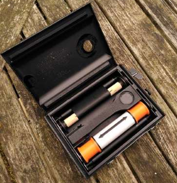

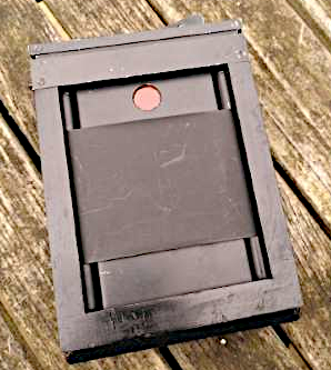

My 1/4 plate reflex camera has a Graflex '51' film roll holder. Until I'm ready to begin working with sheet film I'm using these orange adaptor reels with 120 film. It's a workable system for now. Pictures below to show how it loads into the 51 roll film holder. Gives me a bit more film real-estate for the moment (I'm getting 60x80mm negative images)
Daniel is a 3D printing wizard and sells these clever adaptor reels (bid-with https://www.ebay.com/sch/bid-with/m.html?_nkw=&_armrs=1&_ipg=&_from= ). They fit a 120 film spool centrally into a '51' holder. It's not perfect because the spool ends are slightly wider than is ideal, but it's certainly easier than re-loading onto the big wooden '51' spools.
I'm now using the orange reels with just the pins to fit into the cross heads of my 120 spools. I tried to use the threaded bolt to go right through the spool and discovered that neither Ilford nor Rollei BW 120 film spools have holes all the way through.
So here's the question: Do your 120 film spools have holes right through? Which ones do and which ones don't? It would help Daniel to be able to add these details to his listing. You can also 'win' a set of 3d printed reels for your own non-standard camera by giving him the dimensions. Look at the end of one of his listings for the details.

ps. If you want to try this at home be sure to close off the red window on your film holder. With the film centrally loaded you can't see the numbers anyway and it could fog your top film edge.
Find I need to wind between 4.5 half turns at the start of the film and 2 half turns at the end to ensure the images are properly spaced on the film.
