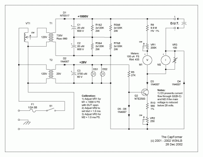

There are various recipes for regenerating electrolytic capacitators, but your time regime makes no sense to me. Only the time with applied voltage will be effective.
The seemingly best ways for regenerating or testing, as these yield full control on the process and its variables, will need to desolder the flash, something with means hassle with compact flashes.

I got your point on the time regime related to built-up gasses. I did not think of that. Thank you.
The idea of regenerating capacitators in the disconnected state is that you have full control on the leak-current, by that (likely) avoiding pressure-built-up.
Problem is that the recipes I know differ on that maximum current by magnitudes...

So far I did not follow that way, but I got a flash capacitator starting to boil within minutes after just switching that flash on.

I recently tested (6) old electro capacitors that I had removed and replaced in a
The process i described was optimized for safety, not efficiency.
It can be done by anyone who has zero technical training and capability without endangering himself or the equipment.
I even use it for routine maintenance because I'm lazy and the process is easy.
For bench work, of course I re-form caps which are disconnected from the circuit.
That gives me more control over the process.
i even designed a 1 milliamp constant-current power supply that re-forms caps using advanced control circuitry.
Here's a PDF of the design (WARNING... this produces 1000 volts open-circuit):
http://www.atwaterkent.info/Images/CapFormerSchematic.pdf
It's a simple matter to modify the design to limit the max voltage to 500 volts.
- Leigh
