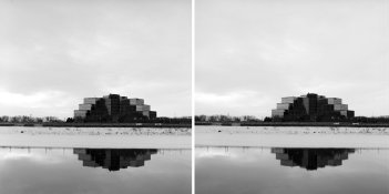

If so, TMax 100 might be your friend.
By underexposing TMax 100 two stops at EI 400, and then push processing in Xtol 1:1, you will get results that are confusingly alike the venerable Tri-X 320 (TXP).
One of the frames below is Tri-X 320 processed in replenished Xtol, and the other according to the recipe above. If I hadn't known which is which, I wouldn't be able to tell them apart. The sky changed between shots.
Both frames scanned according to the same scanner settings, and processed together using the same changes. No individual changes, except overcoming the higher base fog of TXP by adding just a hair more contrast in the black on that frame.
Grain, you say? Of course TXP will have more grain. But perhaps the sharpness of TMax will help you overcome your loss.
- Thomas

Thomas, what was your time and temp for the pushed TMX?
Pretty remarkable test.
I don't remember exactly, but I think it was 1:1 for 14 minutes, agitating every 2 minutes.

when you look at the grass covered by snow aside of the river/canal, you can see that the one on the left shows more "apparent" or real detail, hard to say from a scanned image. I wonder why this detail is not as pronounced as on the image on the right. I am inclined to think that the one on the left is TXP, but I am not sure and this is not a competition. But I'd like to know, regardless. Thanks for posting this test.

Thomas Bertilsson
