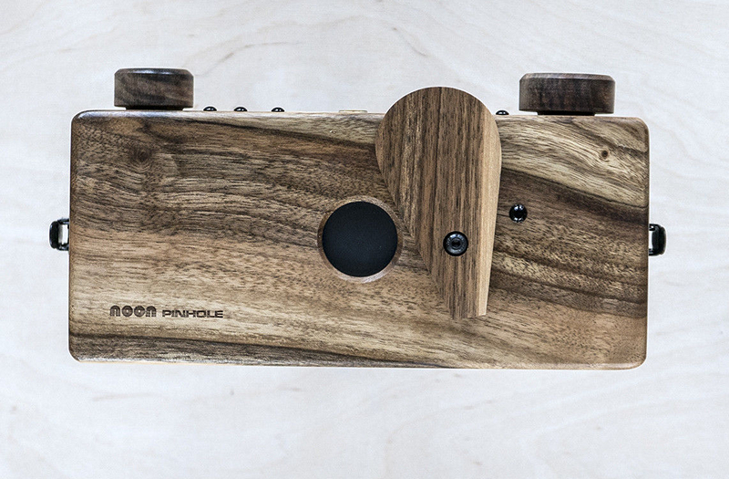

I lean toward the more expensive option - isn't this pretty?
Yes it is. And there is certainly nothing wrong with that. I have some photographic tools that I keep simply because they are pretty and look nice on display.
My preference in pinhole is larger format, 4X5 or curved 5x7 using photo paper as a negative. That means home build for me because it’s just so hands on and......well....cheap. I kinda like paper because it is easy to get results fast and make necessary adjustments or changes same day if need be.

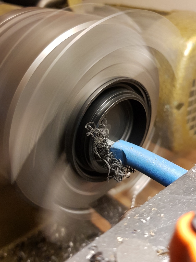

I lean toward the DIY option - just machined a body cap to fit it with a recessed pinhole for shorter focal length.
