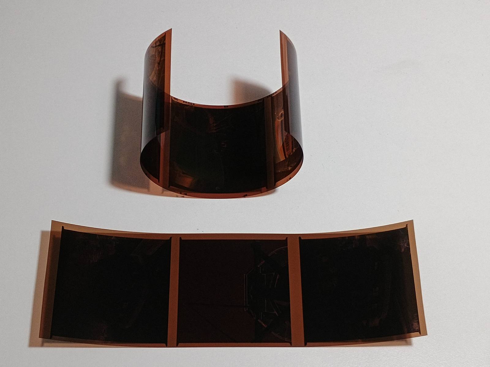

I left some under a pile of books for ages and the film refused to flatten itself enough that I could avoid getting newton rings in the scans. It curls back up as if the material has 'memory'. I may switch to a different, flatter drying color film (if any exist) once I run through my stash because of the curling and the limiting ISO.
The Epson v850 medium format film holders could be a lot better!
*Edit: ages means a few weeks.

I may have to try Lucky 120 film. I like Kodak Gold, but the way it curls and stays curled after weighing it down for weeks is very frustrating.
The curl problem, in my experience, occurs when drying.
If you dry with heated air while holding the film taut it dries without curl.
I use a heated air blower and weight the end of the film

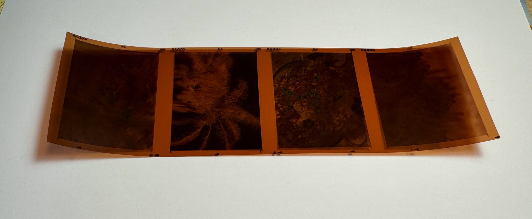

All I know is the latest 120 films from Kodak are so curled that you NEED to use a Printfile or some contraption to hold 3 or 4 strips flat to make contact proof sheets. Pain in the &ss!
My theory is that the specification for flatness must be different, or there's been a change or elimination of an anti-curl ingredient. Something is different, it ain't a shift in the Earth's gravity!

Post #2 photo is what I've seen.
