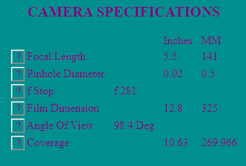

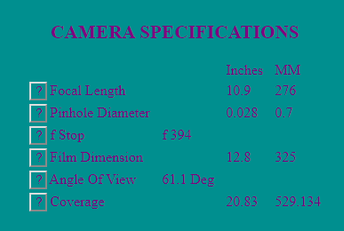

I'm planning to build an 8x10 inch pinhole camera. I have a set of pinholes that range from 0.1mm, 0.2mm....1.0mm.
I went to the Mr. Pinhole site and plugged in the numbers. It suggested this would be the optimal design. I've never done this before so I was hoping someone more experienced could take a look at them before I start building.

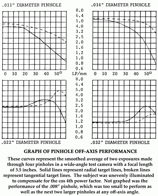

For pinhole photographers who like the sharpest possible photos, wide angle cameras beat those with normal or longer focal lengths. The reason for this is the image sharpness with a optimal size pinhole is related to the pinhole diameter. The shorter the focal length, the smaller the pinhole and the sharper the image on the film will appear at a normal viewing distance. This does not mean small format pinhole cameras render the most detail. We tend to enlarge or at least look closely at small photographs. The detail in an optimally sharp pinhole camera does not increase proportionally to the focal length, but at a slower rate, .7 as fast as the focal length increases. A wide angle 8x10 pinhole camera can produce a photograph of some subjects that appears fairly sharp at normal viewing distances. Although I once struggled with a pinhole camera with a focal length of about 24 feet to shoot an eclipse, I almost always stuck to wide angle pinholes. They do have one disadvantage. The light falls off in the image corners. This fall-off is at least two stops when the camera covers 90 degrees. Sharpness also decreases. The charts below compiled decades ago show this.

OK, you both have convinced me to try a shorter focal length. I went with the 0.5mm pinhole and this is what I got, it may not cover the entire negative but there is only one way to find out.I started building it last night.
