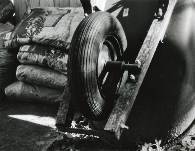

Wayne, I printed a couple of images and they were pretty soft. I do know of a guy who shoots on something like 8X10 paper and then enlarges through the ceiling of his garage to the floor and makes some massive prints. I would guess that he does 5-6X enlargements. I think that the idea is to go with the lack of sharpness and make sure that it fits your image. I will see what I can hunt down and post if I can find it. One good thing about the pinhole I sent you is that the hole is very small and precision cut. That does give you a sharper image than with a larger or rougher pinhole.
Wayne, here is a scan of a print from the pinhole cap I sold you. I did the normal amount of Photoshop sharpening and otherwise it is just what the scanner captured. Not much of an image, but the sharpness isn't too bad. In some ways, I felt that the images I was getting were a bit too sharp for pinhole images.
Thanks Paul; It'll work for me just fine. Let me know how the 67 pinhole works out. I might have to make one myself.
