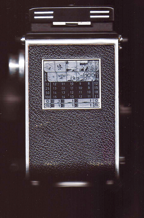

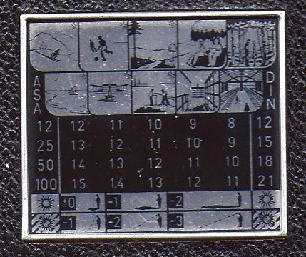

My camera had it all on its back...
PS -- must not have been much 400 ASA film back in the early 50s...

Perhaps back in the 50’s they assumed that people know how to multiply. :smile:
Vaughn
Dec 13, 2006
10,096
Humboldt Co.
Even easier! On that chart one just has to add! In the forest or in your local train station (middle of the day, no clouds) at ASA 100 it is 11...ASA200 it will be 12, and 400 it will be 13. I'd use it if I could not find my meter ...close enough for me at the time (late 70s).
