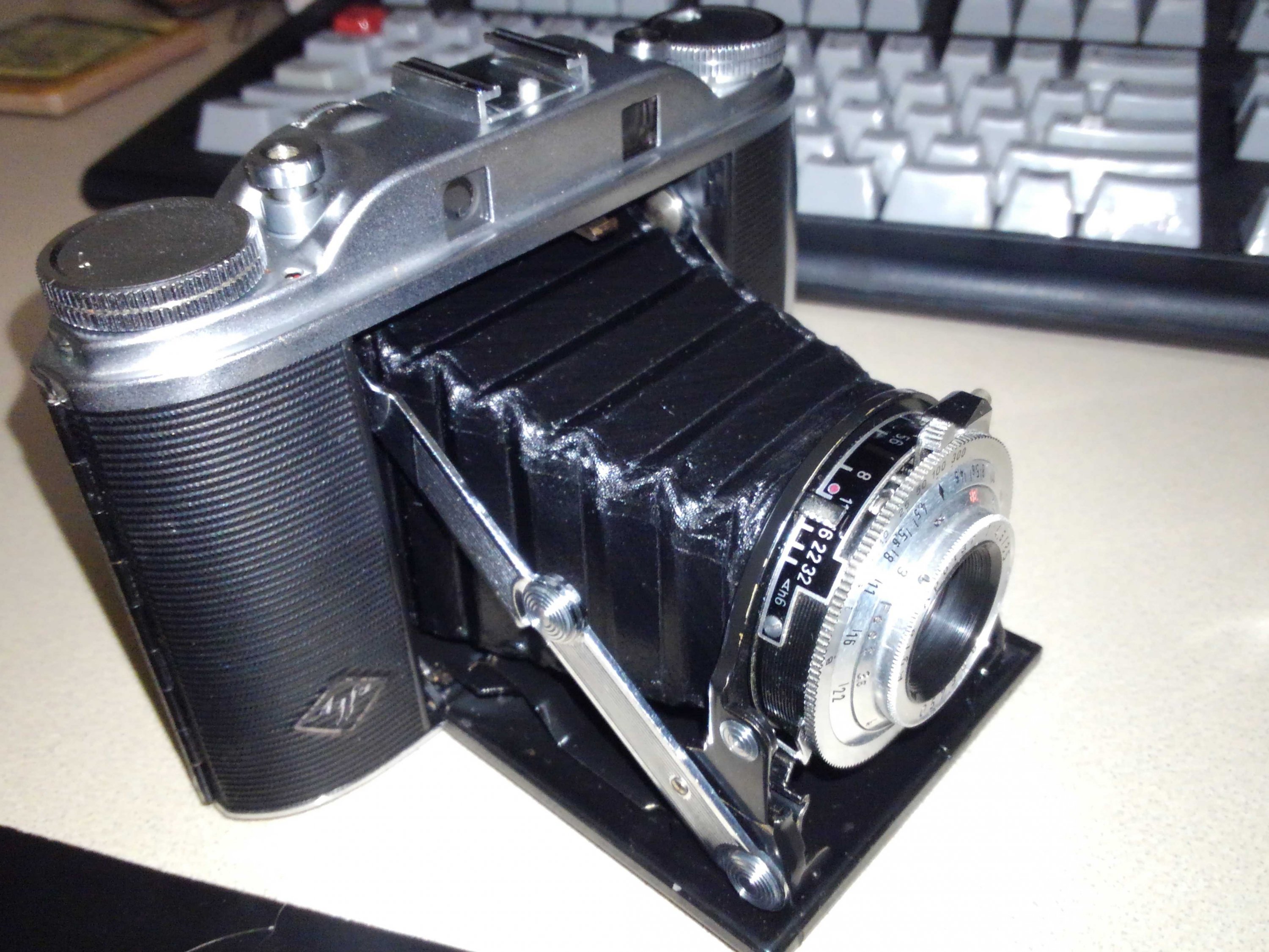

I have an isolette that I'm ready to replace the bellows on (with a really nice kodak 66 bellows). Do I need to refocus to infinity after removing and replacing the shutter, all things being equal? I don't have any ground glass, and I can't see very well with the scotch tape method.

Well, as a matter of course, I would check that infinity is infinity.
You can use a short length of 120 film that has had the emulsion sanded off to make a faux ground glass. Make sure it lays flat in the film plane...
Or, just gamble a roll and see what you get.

It's an old cinematographer's trick for gate-focusing a hand cranked camera without a reflex viewfinder...

If you get ambitious, it's not too hard to make your own ground glass out of normal plate glass and a simple glass cutter. Doesn't take long...

My first bellows install. Kodak must have sunk all their money into the bellows of the 66 II. Even though they are cr*p cameras I felt guilty dismantling it. The kodak 66 II bellows are a little smaller / tighter fit but the forums didn't lie. Too bad the price has gone up on them.

An alternative to wax paper is tracing paper available from an art supply store, often available in various thicknesses and finishes according to need. I'm glad the wax paper worked out for you.
