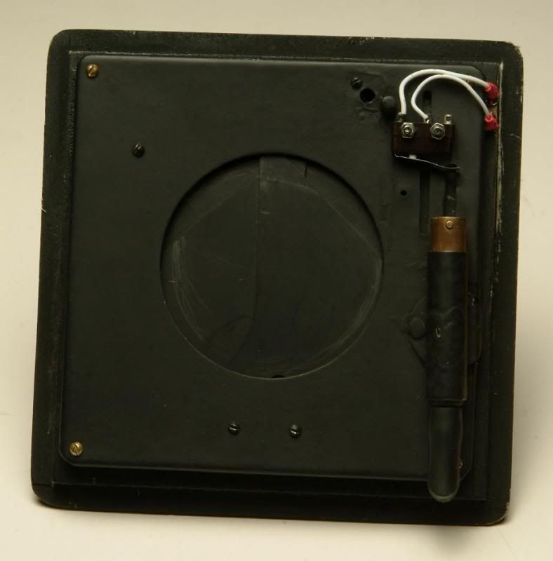

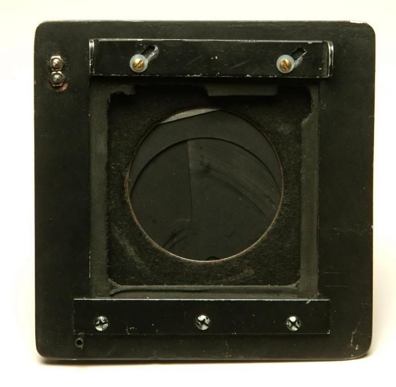

What I did for my C1 was fabricate a lens board out of 3/8" plywood, then make it into a 4x4 adapter, and mount a packard behind it, adding flash sync. Not terribly pretty, but works well. The advantage is that I can use any lens I have mounted on a 4x4 lensboard, my 4x5 camera (toyo 45F) has a 4x4 adapter as well (just need to find another packard for it.) and if I mount a lenst that has a shutter, I simply open the packard and use it as an adapter. By permanently pinning the shutter, with a small finishing nail, you can get either instantaeous by squeezing hard, or B/T by squeezing slowly (thanks to Ron Tuttle for that tip!!)
front:
back:
