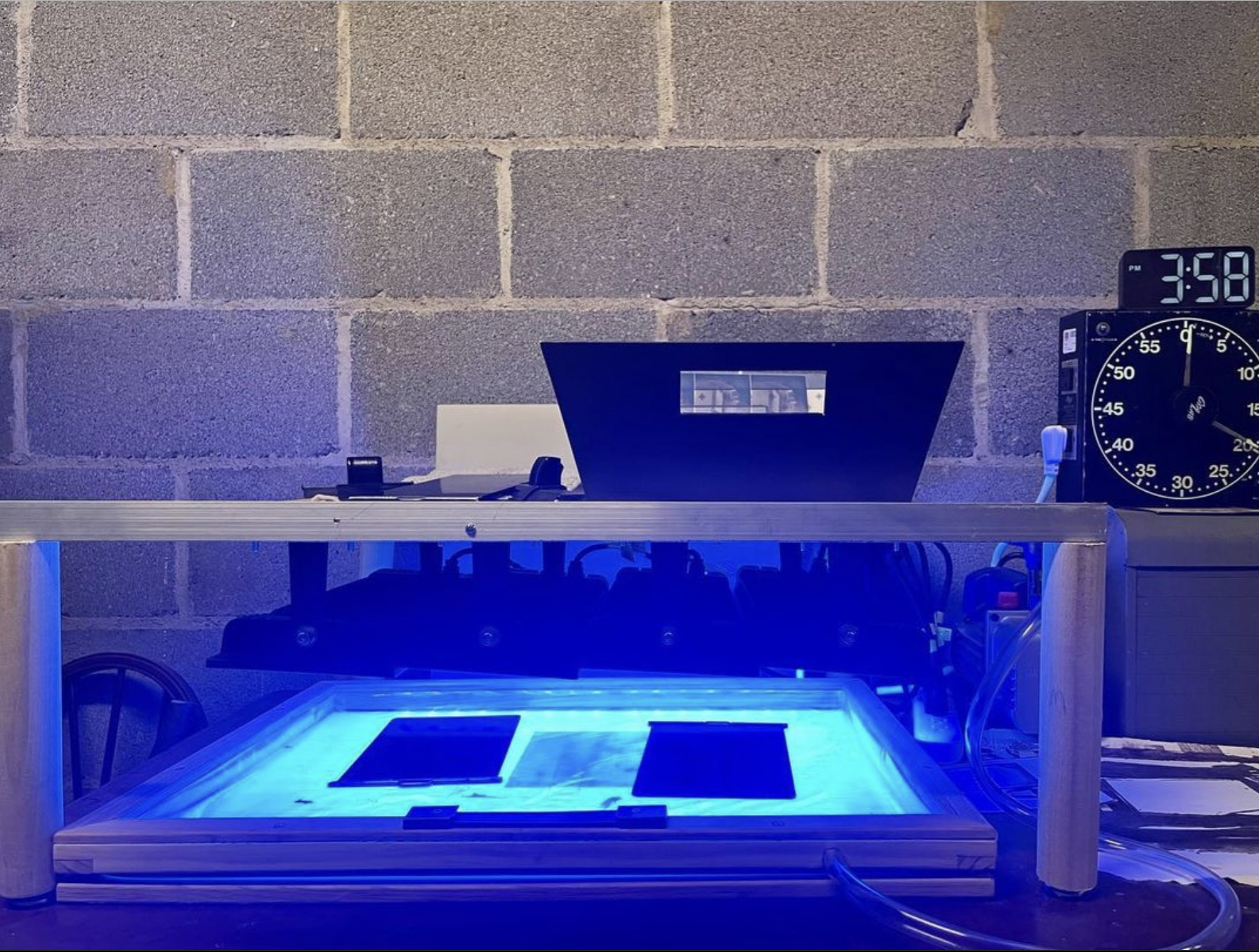

David, I am not on the PHOTRIO Welcome Wagon, but I'll welcome you here all the same. There is a lot of cumulative knowledge archived here, and a lot of current users who have experience to share. Stick around.
I am glad you found the suggestion useful. I tried a couple of other solutions, and like you was preparing to spend a lot of time and money building an exposure box from scratch, when I found these lights. Honestly, they are a thousand dollars cheaper than the usual solutions (NuArcs and such), and faster and more reliable too. Using a vacuum frame with a clear vinyl top (which removes the glass, which absorbs some UV light) my exposures are 23 seconds for kallitypes.
You are correct: I hung the lights, using the included brackets, from the bottom of a sheet of plywood that stands on 9-inch legs that I cut from a poplar closet hanging rod. That leaves plenty of room for the print frame. I'm attaching a photo so you can see how I've set them up.
Feel free to ask questions, here or in a private message, if I can offer any additional help. What process are you expecting to print with?

Sanders - Thank you so much for answering my question, and attaching a photo of your set-up, that makes it very clear...I have been "trolling" the alt photo stuff here on Photrio and have found it very useful as well. I did some cyanotype's last summer and got some OK results ( however interrupted by a house project and am just getting back to it). While the cyanotypes were OK and I learned all the curve/digital negative stuff, I am not that enamored of the blue color.

Dave, happy to oblige. Several thoughts:
Before you give up on cyanotypes because of all the blue, you might want to investigate the vast range of toning possibilities that cyanotypes offer. Toning with various tannins can give beautiful tones. You can do a deep dive into cyanotypes, using new formulas pioneered by people like Mike Ware and Sam Wang, and using all sorts of split toning techniques that produce gorgeous results. Routledge published a book on cyanotype toning by Annette Golaz in 2021, that is a worthwhile source book on the subject. It's not my medium, but I respect the process and its possibilities.
My medium, at least for now, has been platinum-toned kallitypes. It is, for me, the sweet spot in the alt processes. If you are considering this route, make sure you read Sandy King's writings, which give a reliable guide to getting started. If you run into problems, ping me -- I'll be glad to help if I can. And while I am not a Facebook user, there is an Alternate Photography group there with over 45,000 members worldwide, and I have found it a good source of information and inspiration.
One big issue as you move away from cyanotypes is paper. Your rag paper stash will work fine for cyanotypes, but probably not for kallitypes or straight pt/pd prints, which are not tolerant to a lot of buffering agents found in most papers. The Bergger COT is one reliable standard, along with Arches Platine and Rives BFK (Irving Penn's paper of choice) and Hahnemühle Platinum Rag. My favorite, FWIW, is Revere Platinum, from Legion Paper (which also sources Arches Platine and Rives BFK). Legion sources it from an Italian mill to Legion's spec, formulated precisely for these processes. Revere Platinum looks and performs much like Hahnemühle Platinum Rag, but is a lot less expensive.

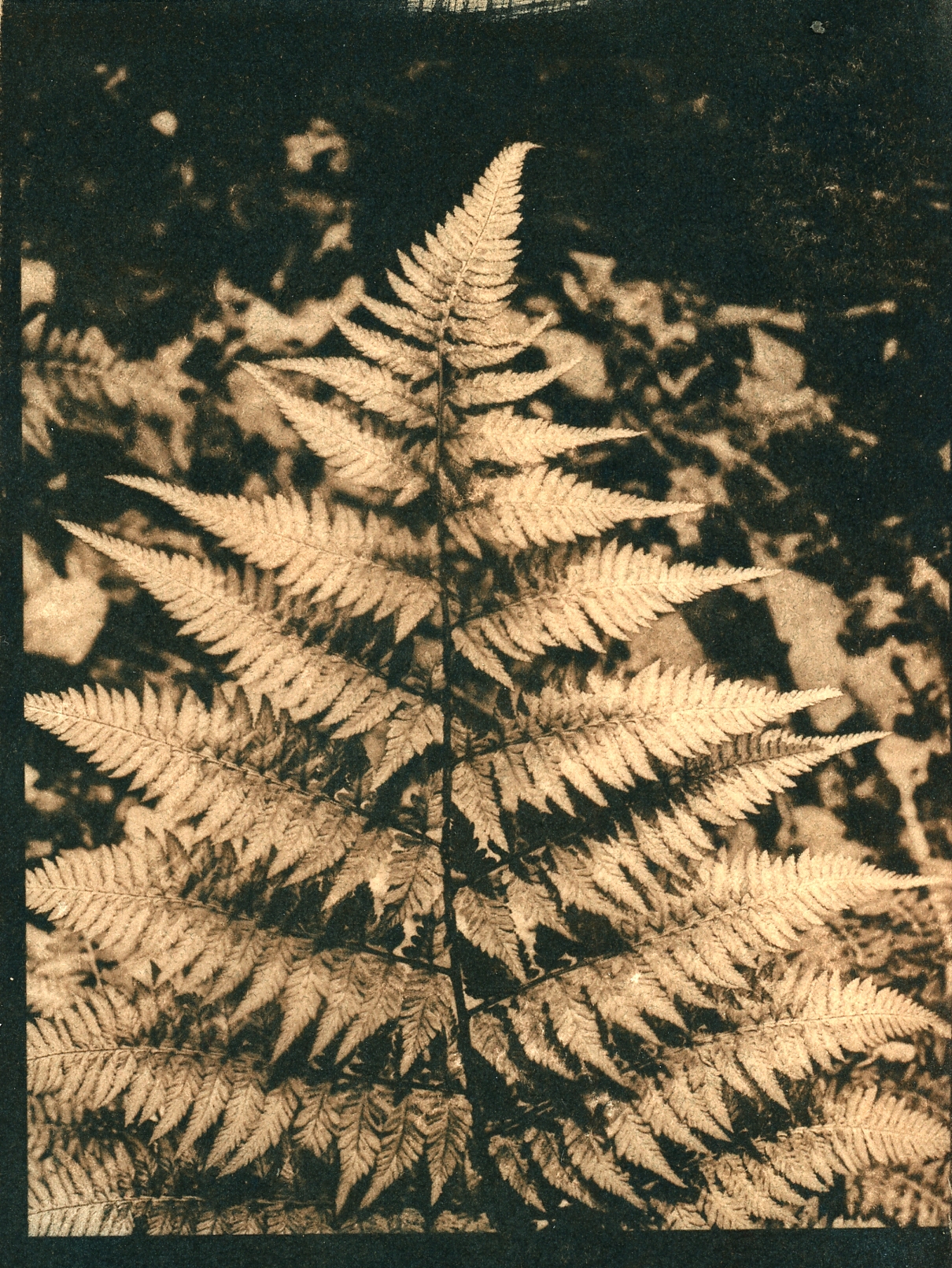

Sanders, thank you so much for your recommendations regarding these processes, sorry to reply via this thread, I would DM but I have too few posting for that feature to be enabled. I tried a bit of toning with tea on some of my cyanotypes (attached), however I was using some kind of cellulose paper or some of my inkjet paper and it stained rather badly and I did not like the results. I have a copy of the Christopher James book on Alt process and it has many suggestions regarding toning of cyanotypes, perhaps with better paper/toning medium I can get better results.
I may circle back to cyanotype, however your recommendations on paper are very helpful - the alt photo sites seem to have a lot of somewhat contradictory recommendations on papers. Interesting comment regarding Irving Penn. Pre-COVID I spent a summer in Pittsburgh and attended an excellent exhibition of his work at the Frick Museum (like all the robber barons, Frick left a few traces in the 'burgh before moving on). I was really impressed with Penn's work, I was aware of his work mostly as a fashion/commercial photographer, however his personal work was also excellent. I do remember his prints were beautiful.
Well thanks again, I hope to get my UV box assembled this weekend and perhaps I will get organized enough to attempt a few Van Dykes next week....also enjoyed the Twain the quote - fully understand I have that problem myself.
