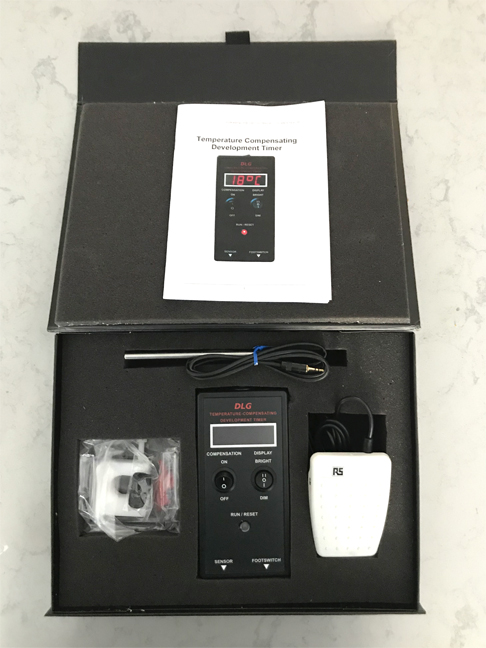

I recently ordered the DLG Temperature-Compensating Development Timer. I formerly had a Zone VI compensating timer, but sold it when I moved into a home where I had a climate controlled darkroom. I moved again a few years ago and my current basement darkroom is subject to seasonal temperature fluctuations, so I ordered the DLG unit.
When the timer arrived a couple of weeks ago, my first impression from a hands-on visual inspection was very good. The packaging immediately reminded me of Apple's, with foam fitting compartments inside an attractive fold-down box with a finished surface. As for the look and feel, the control unit feels sturdy, and the metal foot petal feels solid. The owner's manual discusses theory and principals of operation; temperature coefficients and compensation curves; operating instructions, and other information.
