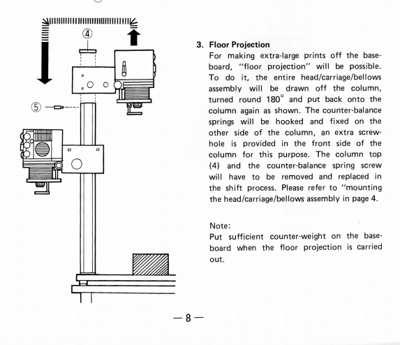

I am in need of making 20x24 from my LPL4500II. KHB Photographix is out of stock on the LPL wall mount kits and no estimate as to when they will be available. Does anyone have some good DIY solutions for this?
adelorenzo
Mar 10, 2012
1,421
Whitehorse, Yukon
You can flip the head around on the column to project onto the floor. Does that work for you in your space?
Otherwise mounting the column just requires drilling four holes so you could build a sturdy, level shelf and mount it to that. I have my column directly mounted to my counter top without a baseboard.

You can flip the head around on the column to project onto the floor. Does that work for you in your space? Otherwise mounting the column just requires drilling four holes so you could build a sturdy, level shelf and mount it to that. I have my column directly mounted to my counter top without a baseboard.
You know, I had totally forgotten that you could flip the head around. That might work with some crouching and bending! I guess I just need to have a low table to hold the easel. Thanks!
That makes a lot of sense, because one big difference between a table-top enlarger and a free-standing one, is the ability to lower the baseboard. In both cases the maximum head height is about the same.
