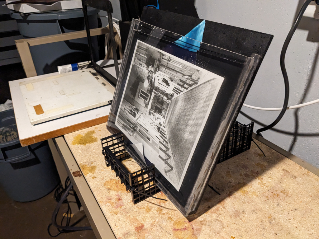

Hey, everyone! Long time listener, first time caller.
I've been printing in a basement storage room for the last couple of years. I print in trays so far, but have been intrigued by the idea of vertical slot processing. I've seen the Nova processors, and a few examples of DIY processors, but had expected I'd see more. I recently came across the Optima Darkroom line of processors and find them quite intriguing. After trying my hardest yet failing to find a way to justify the price, I decided that it could be a fun project to try to make one!
I've worked with acrylic in the past in service of my aquarium hobby, so I bought some acrylic and epoxy and got to work. The build is pretty straightforward.

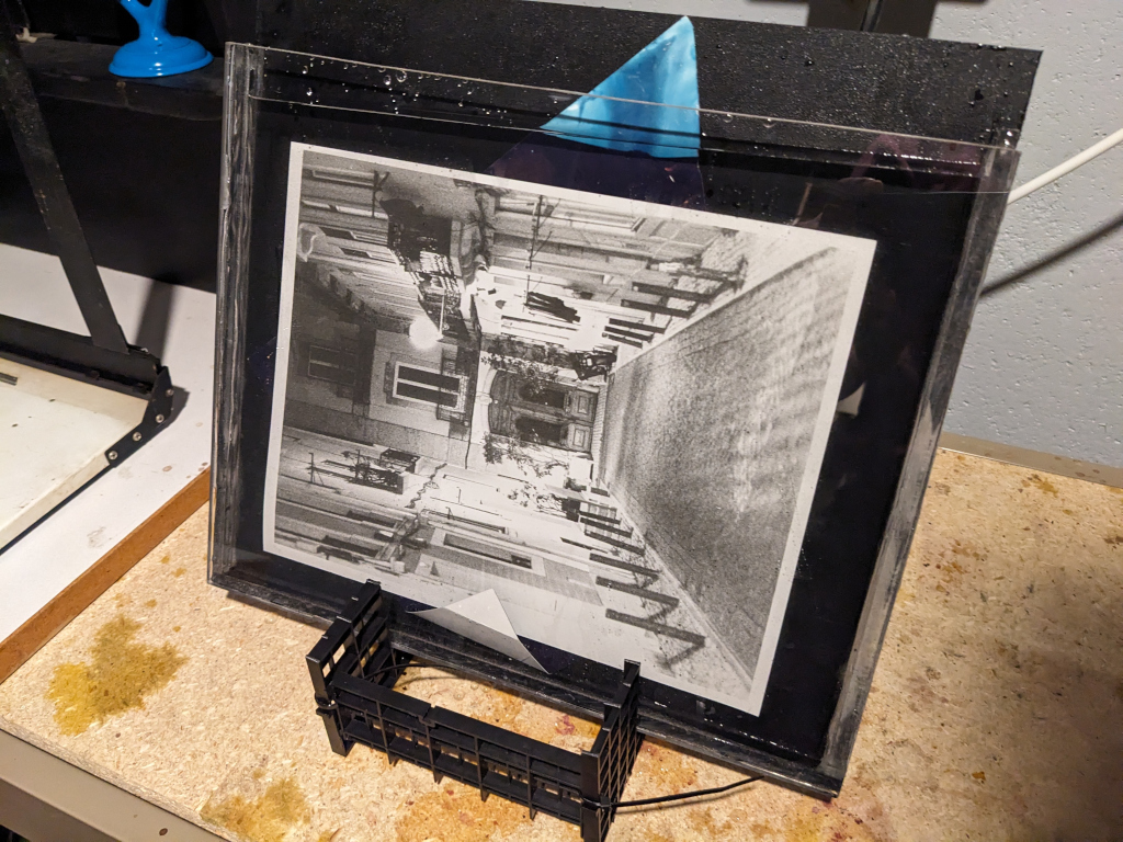

My first prototype didn't work out, as the slot was too narrow and the photo paper would simply stick to the front face. I switched to a textured HDPE backing layer and made the side rails 1cm wide, and this second prototype seems to work quite well. I just finished my first printing session with my second prototype and I'm pretty excited with the results so far!
I initially just stuck the paper directly in, allowing it to stick to the back layer, but it was super challenging to get out with my rubber tipped bamboo tongs. I then folded over a corner of some old photo paper that I used for dodging and use that as a carrier. The folded bottom sticks out enough that nothing touches the front surface of the photo paper.
Here are some photos of my set up at this point. This is just water with a black and white experimental print, as it's not a terribly interesting photo without anything in the slot. I've got a temporary stand that I threw together tonight so I could try it out, but I plan to cut a nicer looking stand from acrylic and make some more slots for my bleach and fix. Finally, I'm thinking that I'll get a small aquarium that I can put this whole setup in with a fish heater or two to keep my chemistry at temp.
I'd love to hear any thoughts or feedback. This has been a fun project, and it's nice to see it working given my...adequate skills.

That's correct. So far this is a single slot. My plan is to make two more that can join this one in a little rack. They won't be glued together, they'll just sit in the rack, so that they are individually movable and so that there'll be a little space between them for water. I'm thinking I'll put them in a small aquarium with water and a heater for temp control, as I print RA-4 and haven't yet been able to do it at the recommended temperatures. 😅

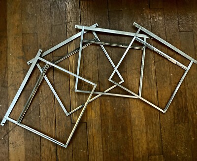

If you are printing 8x10 size consider using a Kodak 4a stainless steel film hanger. I've used these in my Jobo Duolab slot processor. Jobo used a wand with tiny suction cups to manage (RC only) paper

I never thought of using steel hangers for the paper, although that seems in retrospect obvious.

Thanks, I haven't done large format yet, so haven't come across film hangers before. That might do well!

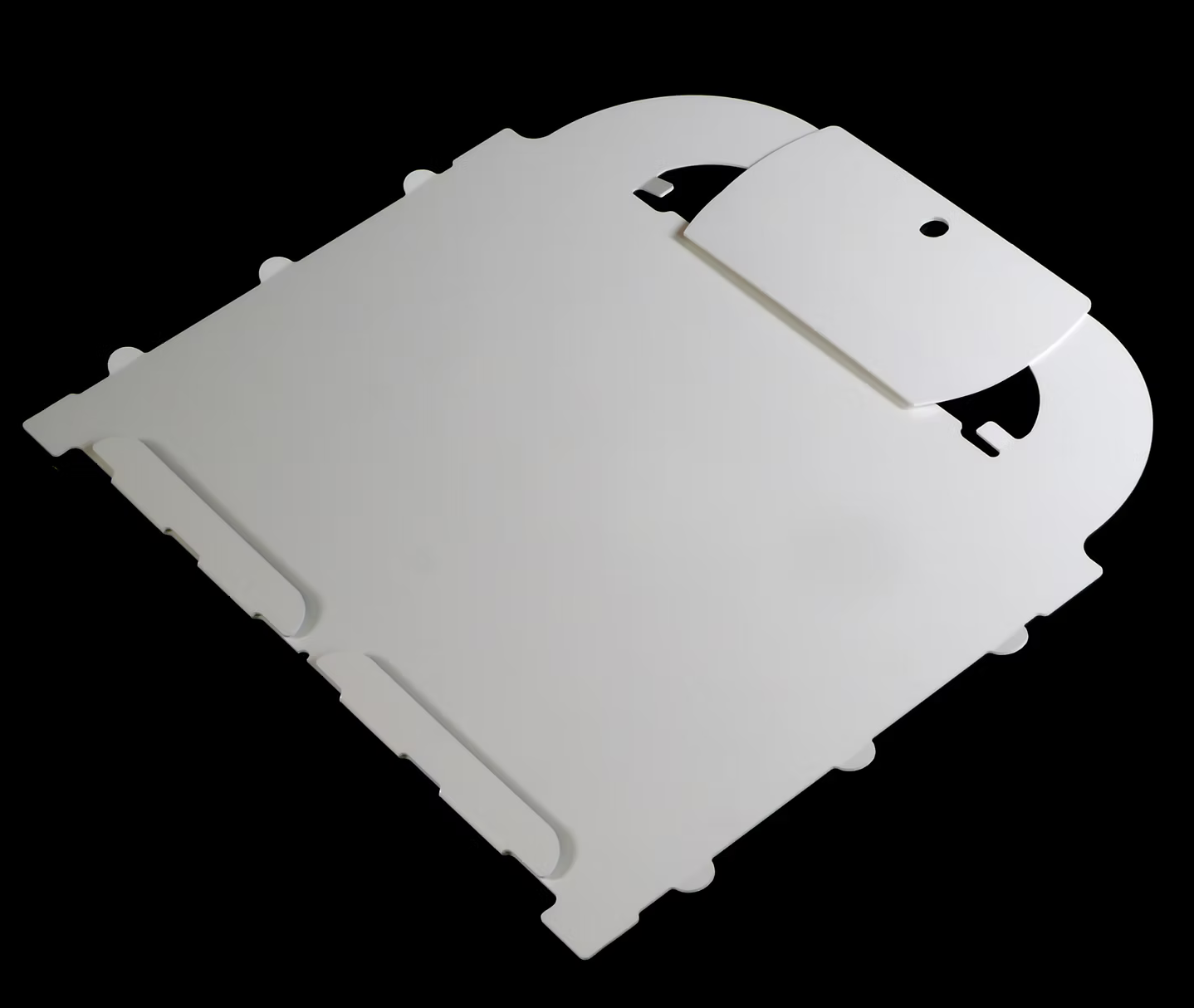

My folded paper to hold the print was inspired by the OptimaDarkroom print holder. With the RC paper facing out, this allows the paper to cling to the older instead of the container, while nothing touches the surface of the paper and the tabs ensure it doesn't rest against the front of the container. In my test prints last night using a very hacked together version of this worked quite well and resulted in good (for my skill level) prints!
