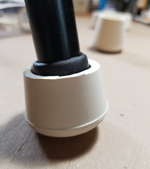

Much of my work is indoors, and although the rubber feet on my 3221 generally work well, they can slip a bit when the legs start nearing full extension.

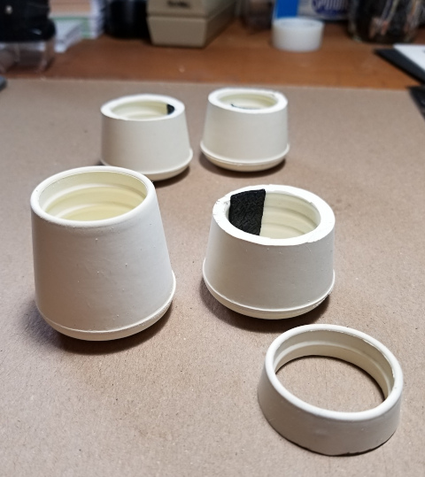

The round feet are just enough larger than 1” in diameter to prevent using 1” rubber furniture leg cups. Well, I subsequently came across some 1 1/8” ones made by Everbilt at Home Depot and snapped them up, even though they’re white. (“Well, I am a B&W photographer after all,” he rationalized.)
The photos show my solution. I used a matte knife to cut off the unneeded top portion (two inner embossed rings). Since the cup would not stay on, I cut a half-inch-wide rectangle from a 2” non-slip self-adhesive pad (same manufacturer) to insert, to take up just enough space to keep the cup secure but allow its easy removal, since I don’t always need it. I rinsed the powdery residue from inside the cups and dried them, and the rectangle adhered well.
Not the most elegant solution, but the traction is great.

I suspect your 3221 tripod is old enough that the original rubber on the ends of the legs have dried out and lost traction due to age!
After all, tires on cars are recommended to be replaced after the rubber in the tire is more than 6 years beyond to date of manufacture of the tires.
You can perhaps still get relacement tips for the 3221s with fresher rubber on the tips, as an alternative to your solution.
Ulophot
Jul 10, 2015
125
Southeastern U.S.
You may be right. When I looked into this originally, it appeared the tips were not meant to be removed, and the model is no longer manufactured. I had also hoped a spike tip would be available, but it is not, and I have yet to find an easy way to create a detachable substitute for relevant outdoor occasions.
AgX
Apr 5, 2007
29,973
Germany
Over here you would not find such rubber feet at all. What there is are PVC feet, that have low friction.
Feet loosing friction is even a major issue with old tripods in general.
BAC1967
Oct 30, 2014
1,422
Bothell, WA
You can get rubber reconditioner. I haven’t used it on tripod legs but I use it on the drive wheel for my old turn table and it works great. The one I use is designed for Rubber rollers in printers and copy machines.
