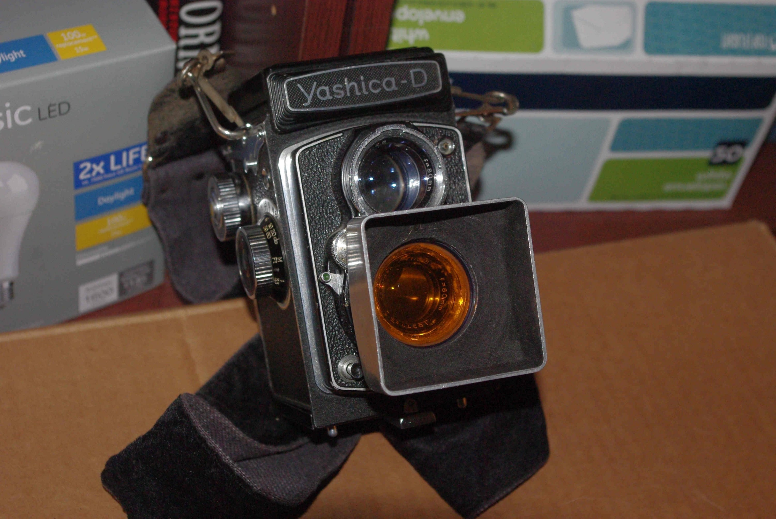

Might be within your pirce range, used SVI adaptor, the kind with flanges that can adjusted by pulling out or pushing in, then a SVI lens hood, most adaptors will allow for the use of a filter and a hood. Yashcia with SVI fitler and lens hood. .jpg

I just ordered one, seems like I can slip in a SVI fitler and the hood will hold in place, unlike my current hood the double hood will help with focusing in glare.
