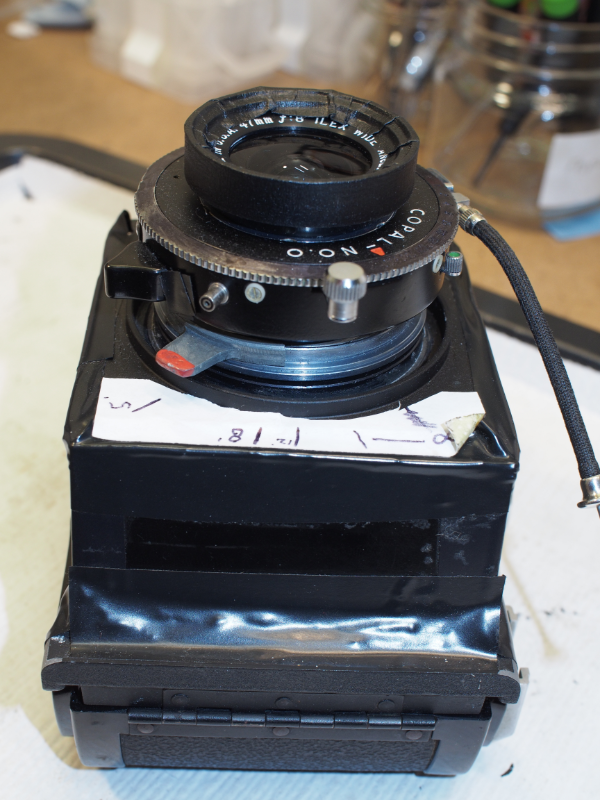

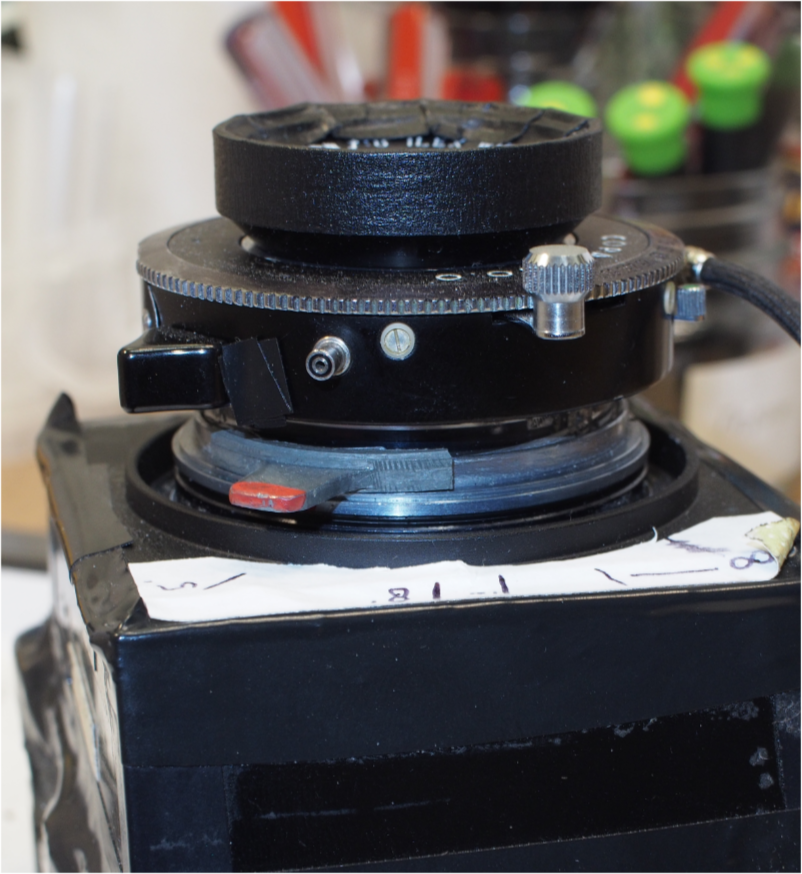

Yes. A cheap old 50mm SLR lens. I sued a Pentax M 50mm f/2 lens. Rip it down to get the helicoid. Mount it to a plate, make a front plate and mount the lens. Speaking of Minolta, the focus lever is actually the stub from a broken focus lever on an Autocord. Level of elegance will be up to you. Gut the lens is the basic idea, put a plate on front to mount shutter, plate on back to mount to your body.
Epoxy will handle a lot of the attachment. A few screws always helps. This is a 47mm Acugon mounted to a Graflex 6x9 back.

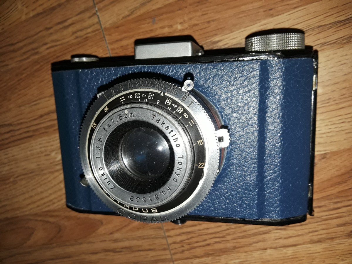

thuggins
Jan 12, 2008
1,144
Dallas, TX
This was an Olympus Six with a disintegrated bellows. The lens was the original, so the lens to focal plane distance is pretty easy to get right. You want it to be a scosh short and shim out the lens.
