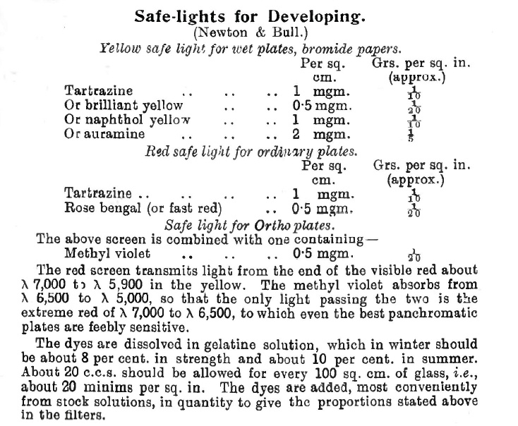

Not surprisingly I actually have quite a few formulae for making your own Safety light coatings, they were published regularly before WWII.
It's also remarkably easy if you have the correct dyes. The early specialists in the field were a pre WW 1 British company, and they still exist and most photographers will have heard the name, Wratten. The company - Wratten & Wainwright was bought by Kodak in 1912, C.E.K. Mees moving to Rochester to set up Koak Research, and Wratten to begin Kodak Research, Harrow.
Personally I'm not interested in trying for myself, but I know an enterprising company did make their own in the late 70's & 80's in the UK.
Here's some formulae from around 1910, see the attachment. Remember that Panchromatic plates were only just become available, so these aren't safe for films except some slow Orthochromatic ones. I doubt any of these formulae would be safe fore Multigrade type emulsions.
Ian

Thanks for posting that. It's a good reminder that people actually used to make their own safelight filters, and one never knows when we'll need to know how to do that again, and when we do, we'll probably be making things like ortho plates with formulas from around 1910.
In the meanwhile, though, used safelights are plentiful and cheap, so I'd recommend just looking on eBay and buying as many safelights as you think you might need.

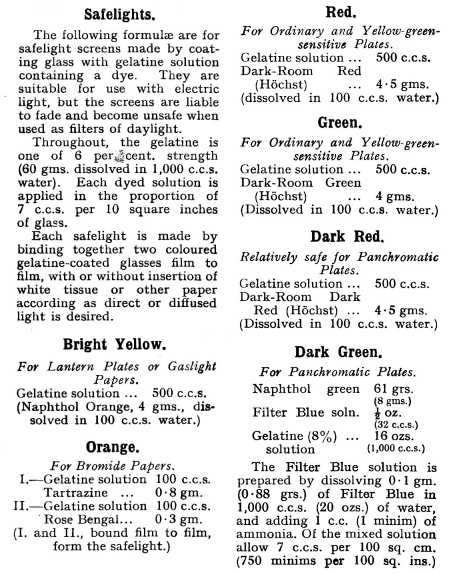

David, there's a whole raft of excellent formulae for POP papers, lists of dyes for Panchromatic "Colloidon" emulsions etc in older books and most of the information is from Research papers. You just have to know where to look.
Eastman started out that way then bought in technology :D re-investing all the time.
Here's more modern safelight coatings, well only by 25 years or so 1935, but a greater rangem from the 1935 BJP Almanac (re-laid out for clarity).
Ian
