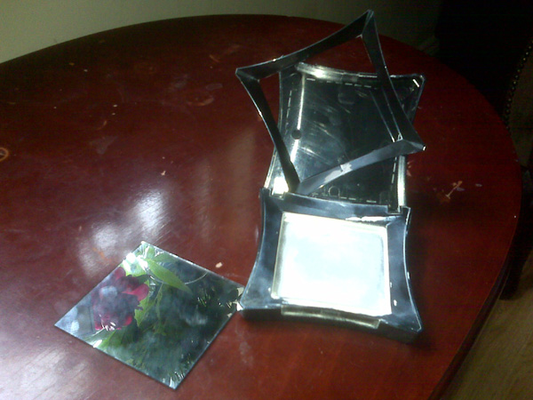

Standard mirror, taken from compact:
attachment.php

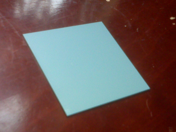

Reverse side with protective grey layer:
attachment.php

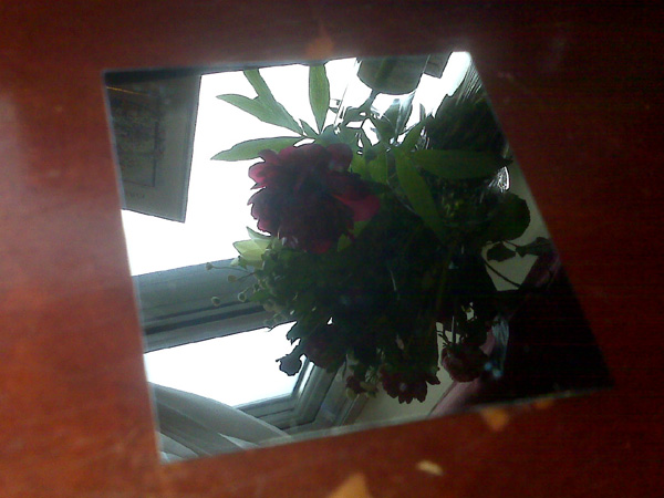

Rear surface stripped of coating:
attachment.php

Sorry about the crappy mobile phone shots. You can see the depth of the glass at the upper right side of the mirror in the first pic.
In the last shot, the reflection comes directly from the metal surface coated on the back of the mirror.
Oops! The thumbnails are in reverse order..
