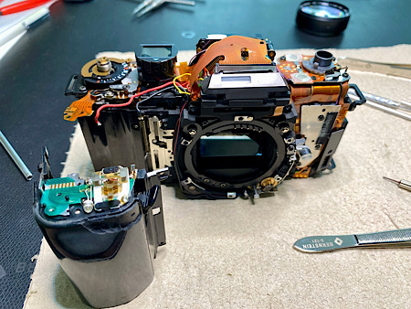

An impressive example of how, with patience, skills and overview, even a super-complex SLR like the Minolta 9000 can be repaired is shown by @ogtronix:
Post in thread 'Minolta (Maxxum) 9000: Dissection and investigating the aperture issue'
https://www.photrio.com/forum/threa...gating-the-aperture-issue.208476/post-2850057

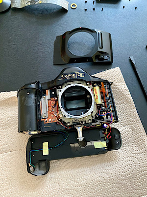

Even just a clearly written instruction on how to remove the top cover of a particular camera, for example, helps others in their work.
For example, once you can open the Canon T90 and partially disassemble it, possibilities for further interventions open up.
