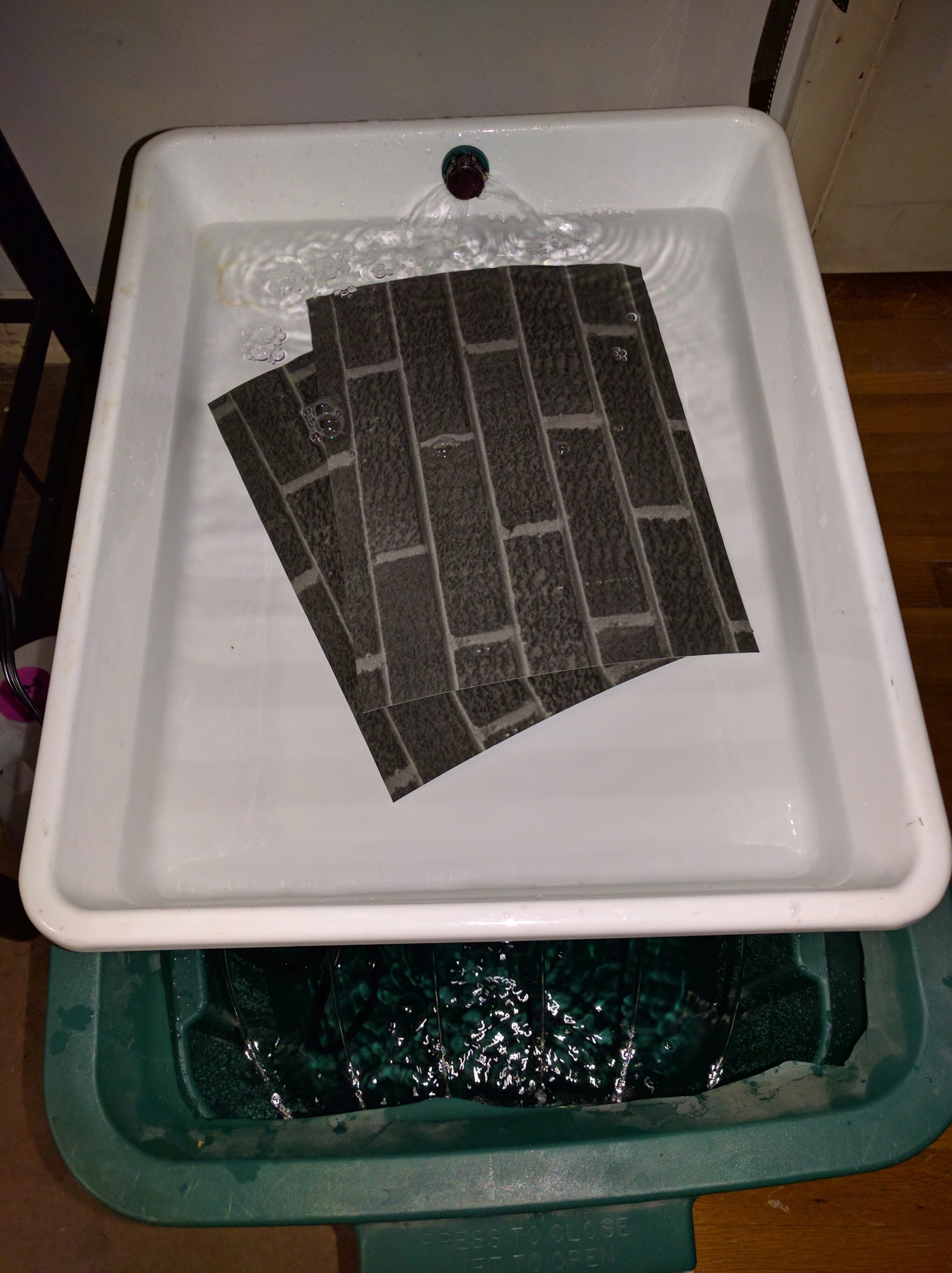

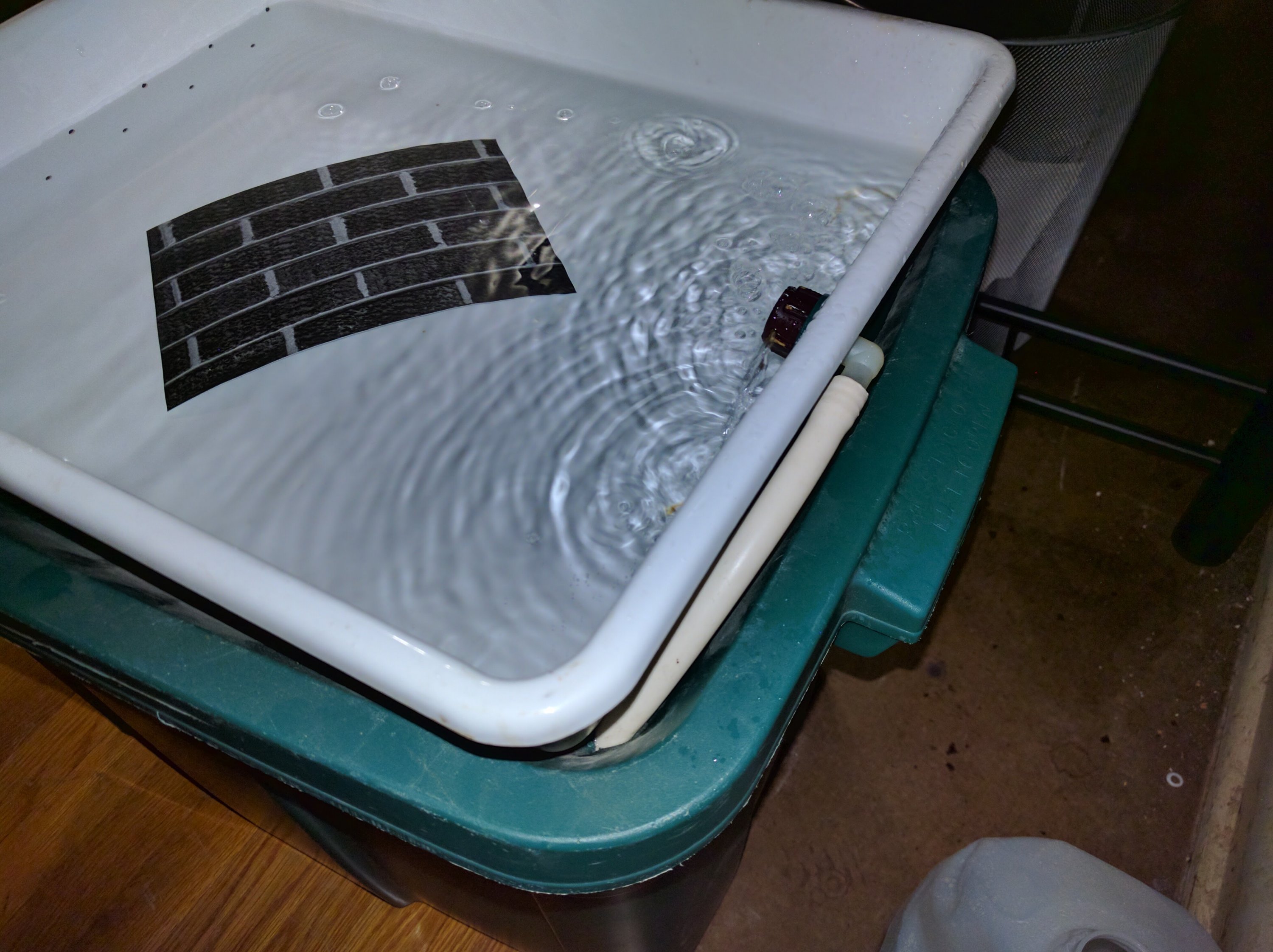

I've been setting up a darkroom in a weird attic space in my new home. This room does not have running water or drainage, so any water that comes in or goes out, goes in buckets.
I've been thinking of a way to wash my prints in this space. I had a wash tray that was supposed to be hooked up to a faucet, as well as a large rubbermaid tub (used for storing assorted stuff, this one had christmas decorations in it). I cut a hole in one side of the lid, for water to drain back down into the bucket from the tray, as well as a small hole for the water line to the tray.

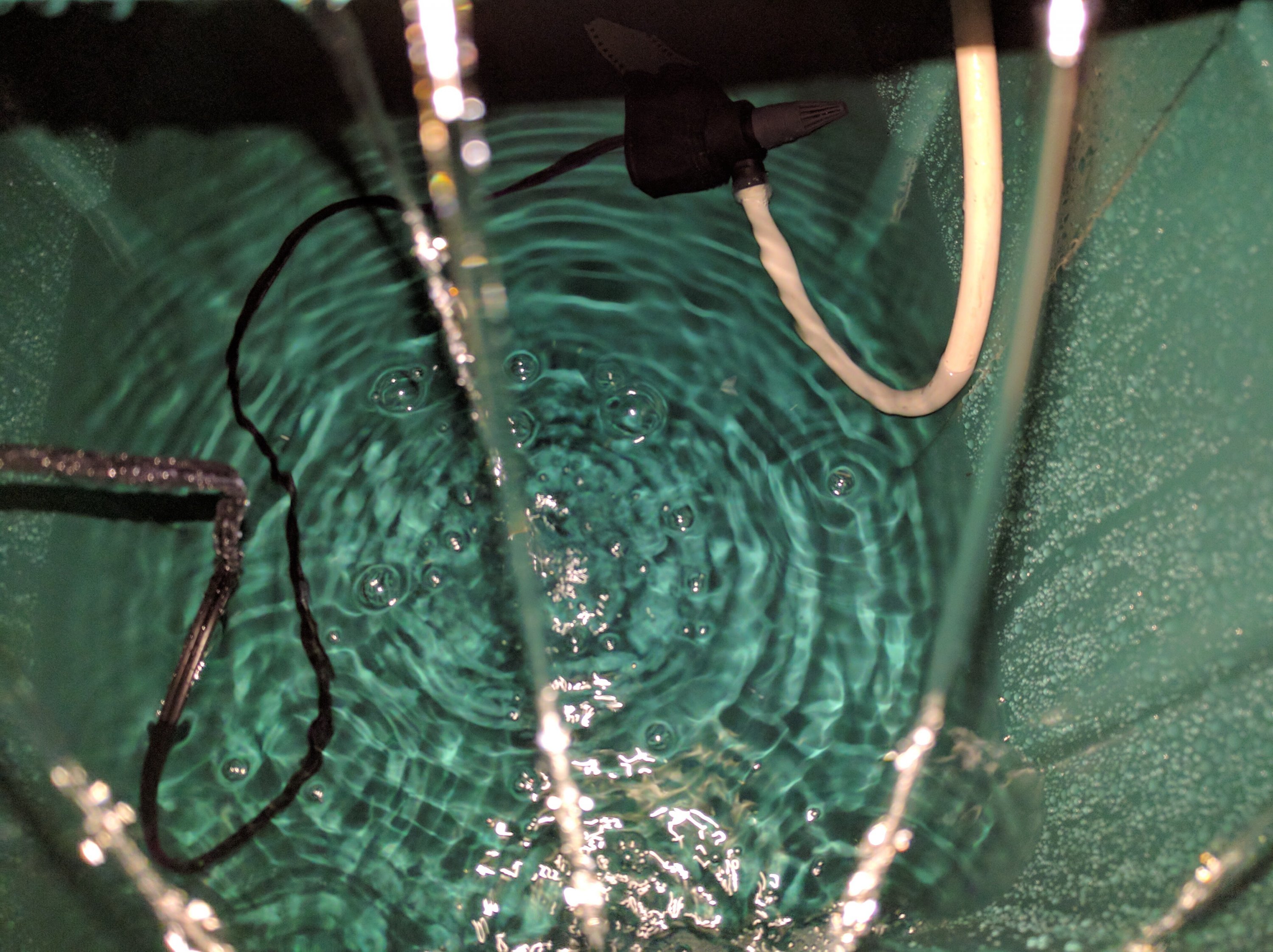

I hooked the water line to a small submersible pump that i've had for circulating water in a tempering bath for C-41 dev (was purchased at walmart in the pet section). The pump has enough power to push the water up to the tray (look for HMax on the pump), and enough flow to fill the tray up to the second set of holes in the end of the tray, and stay there.
I've filled the tub with about 8 gallons of water (I've got two 5 gallon buckets that I fill with about 4 gallons so I don't slosh water all up and down the hallway). After 10 prints or so, I replace about half the water using a secondary pump which is a bit more powerful and much faster than the first.
Before putting a print in the washer, I have a tray holding about a gallon of water that I rinse with first, to get most of the most concentrated fixer out. When I replace the water in the tub, I replace the water in the rinse tray with some of the water in the tub.
I haven't had a chance to run a test to make sure the residual fixer is gone yet, but I will do that soon. If anyone has any thoughts or opinions, or any suggestions on improvements, let me know. In the mean time, I wanted to share this with anyone else who might not have running water in their darkroom, and has about $15 to spend on a part washer.
Anyway, here's some pictures

That looks pretty darn good ! You're absolutely correct to rinse the prints first . In fact I would use several small volume rinses before putting in your washer . 3 or 4 1 minute washes first with 8 to 10 ounces of water each . Another trick is before you develop (assuming you are using fiber base ) is to presoak the paper in room temperature water for about a minute , before you put it into the developer this will saturate the paper with fresh water so there's less chemistry absorbed , and less to wash out .
You've got a nice laminar flow washer setup , test it with some Kodak HT-2 hypo test reagent , I think you will be surprised how well your setup works . I have a couple archival washers the biggest problem is a lack of velocity of water and tiny air bubbles forming on the print surface , you've got those problems licked .
Best Regards Mike
