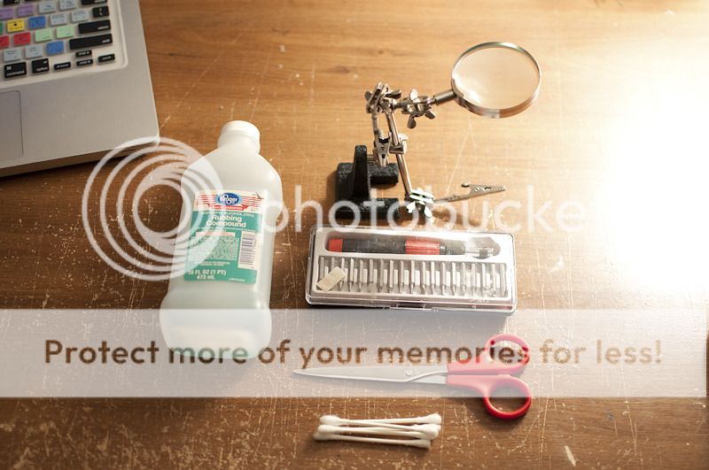

1. First step is to gather all of your stuff. I used:
  • Screwdriver set
  • Rubbing alcohol
  • Q-tips
  • Brain (optional)
  • Helping hands (optional)

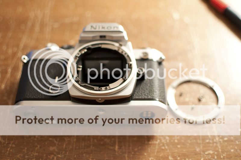

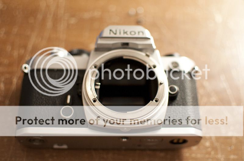

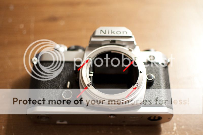

2. With the camera mount side up, begin by undoing the four screws that hold the mount onto the body.
3. Screws removed.

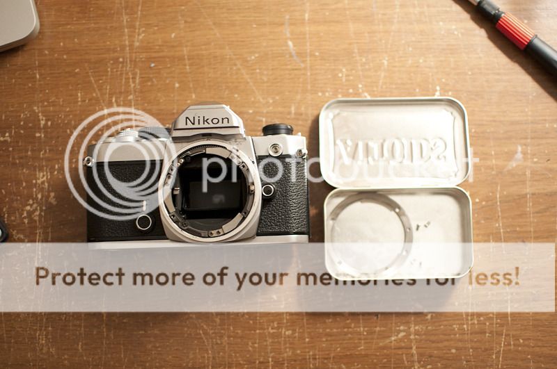

4. Next lift the lens mount off the body.
5. I like storing small parts in used Altoid tins. This prevents mad tron from losing stuff and throwing things everywhere.

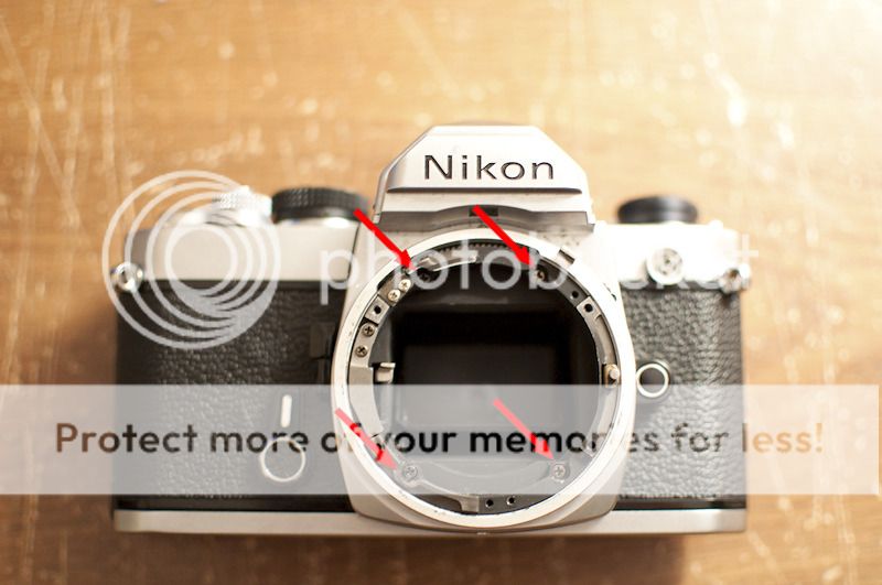

6. Undo the four screws highlighted below. Some FM's have a little tin gasket, this one does not (my black one has the gasket). If you have the little tin gasket, simply lift it off and skip to the next step. If not then undo the following screws.

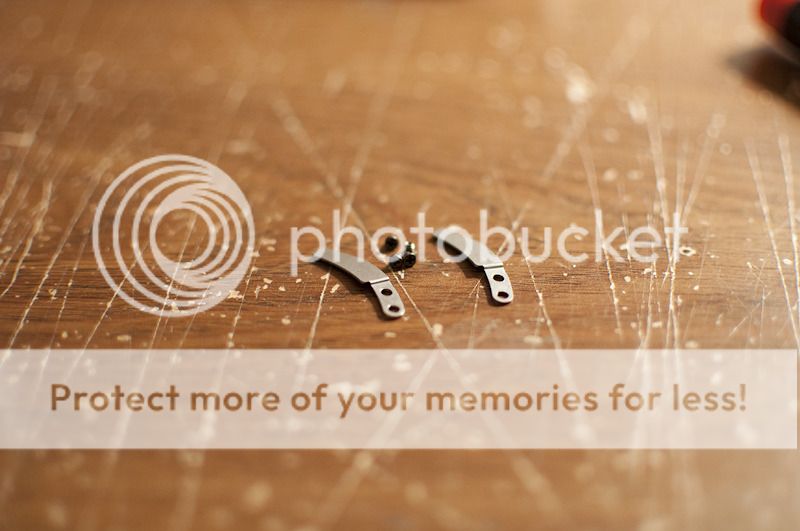

7. Lift these tabs out and set them to the side.

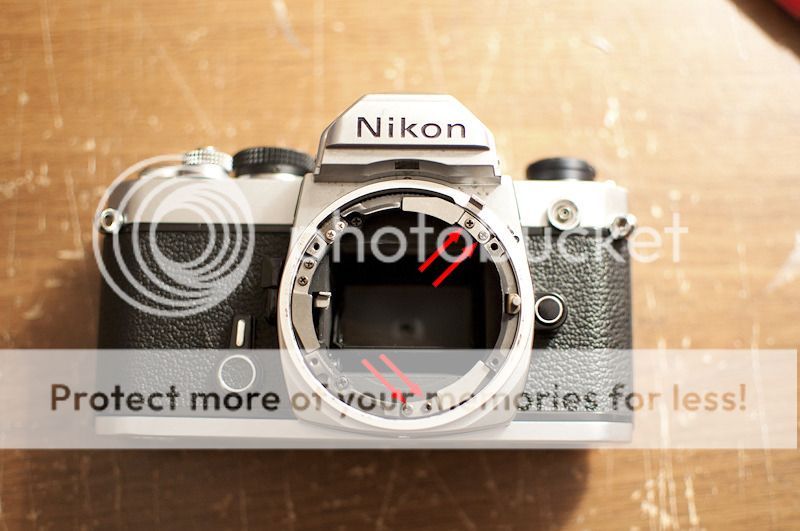

8. Remove the following screws. These hold the metering ring to the body.

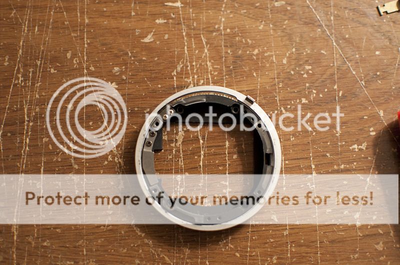

9. Now lift the metering ring out of the body. Also slip the lens locking pin out of the body (the little gold tab at the 3 o'clock position in the previous photo).
10. Set the camera body off to the side and now you have your metering ring.
11. *Lift the inside (black) *portion out of the outside (silver) portion. *There is a spring that links the two pieces together so be gentle. *After removing the pieces you will have the following:
12. *Here is the dirt that is causing the ring to stick and not retract to its original position.
13. *Here is the ring on the inner portion. *Its hard to see in the picture but trust me it was there.
