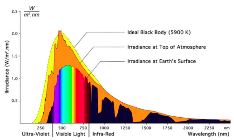

The atmosphere will attenuate quite a bit in the visible range. here is a link to the spectrum. https://www.sciencedirect.com/topics/physics-and-astronomy/solar-spectra
Attenuates it in the direction of shifting the peak further to longer wavelengths. The norm is for opacity to shift a spectrum to longer wavelengths, not shorter ones (caveat for absorption lines). Here's the plot from your link:
Notice that the peak has shifted slightly toward the right, and is clearly at a wavelength longer than 500 nm. Blue is 450-495 nm. Green is 495-570 nm. Whether we look at the location of the peak or the integral under the curve, this plot says that there's more green than blue hitting the Earth's surface.
EDIT: Once again, it is always possible that I'm wrong and I want to be cautious here... But... I think I'm right about this.

To follow-up on my previous comment: Notice that in the plot the ratio of the irradiance at Earth's surface vs irradiance at the top of the atmosphere decreases for shorter wavelengths, at least for lambda < 800 nm. Compare the height of the two curves as lambda decreases. This is the Rayleigh scattering that also makes the sky blue.

Wikipedia has a nice plot on this topic:
Using Wien's was not wrong; it was the sort of imprecision you'd expect from casual low-stakes conversation. It's a reasonable stab at identifying where the Sun's output is. If we were being precise, we should instead be computing the total irradiance within each frequency band. Then we'd get into a debate about whether it's cheating if one color is associated with a wider wave band than another, and whether cyan counts as green. 🙂
