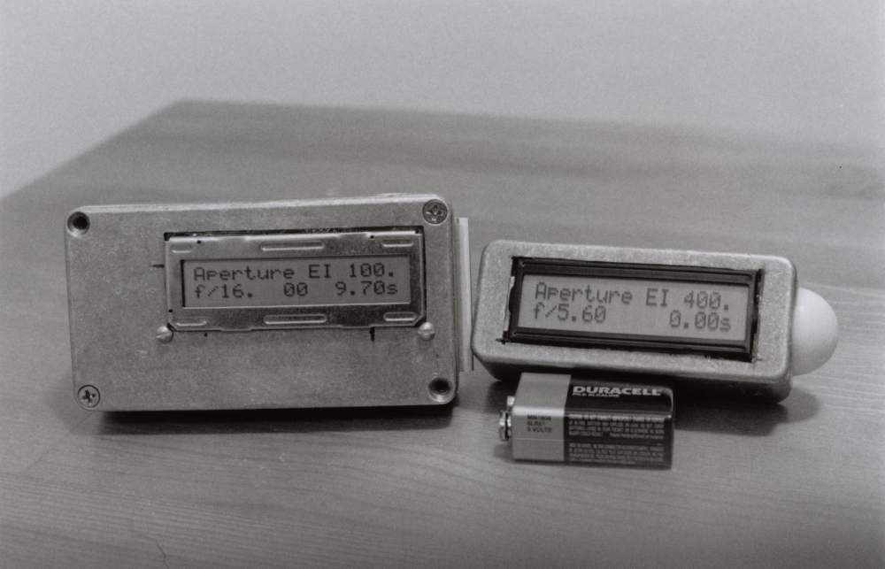

Then perhaps you should provide a link to the plans and circuit diagram!
There is no real circuit diagram; all the information is in the TSL230 datasheet. Here's a picture of two of my older meters though.
I'm interested in how you narrowed the field of view for the spot meter (lens?, pinhole?). Does it have a viewfinder so you know what you're pointing it at?
BetterSense
Aug 16, 2008
3,151
North Caroli
I just use a lens, exactly like a camera. The longer the focal length, the smaller the angle intercepted by the sensor. Brightness is controlled by F/ratio exactly like a camera, so a longer lens tends to have a worse aperture, though. Right now I'm using a coated, F/.9, 18mm lens, which is very compact, but only gets me a 4 degree spot in low light. Since my sensor can adjust its active area according to brightness, in medium (room) light, my spot size is .4 degrees and in sunlight it's theoretically .04 degrees although with flare I'm not sure that's a meaningful number.
If I wasn't a compactness maniac I have a f/2, 50mm lens that I would use. I suppose this is similar to the lenses used on Pentax spotmeters and so on.
Aiming is accomplished by sighting through a peephole that runs through the length of the meter, which consists of 4-5mm diameter aluminum tubing. It's a bit squinty but works well. I've considered adding some rifle sights, but they would stick out.
