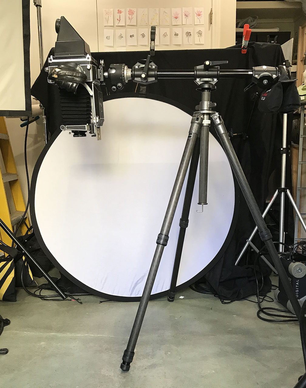

How big and heavy is your LF camera? From your original post, you mention the option of using a copy stand, so I guess you don't need too much height. Here is a photo of a Linhof Technika on the Manfrotto arm I mentioned before. (Sorry, it's a bit cluttered in my tiny studio right now).

How heavy is that weight? The arm is not an option for me. I'm glad it works for you.
