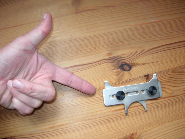

I'm just a humble hobby photographer but I do know a little bit about cleaning optics from my day job, so I'll try to help with advice if I can....
First of all you are probably going to need a lens ring spanner wrench. A photo is attached (there are many designs). This will cost you a lot more than your lens, but maybe you can borrow one, source one cheap on eBay, or make one? You may decide to use the edge of a screwdriver in just one slot, or crossed screwdrivers. The ring will be very tight, so you will slip and then scratch the lens. Its kind of traditional! :wink:
Sometimes you can use a large rubber bung that just fits the ring. (You can actually buy sets of these in different sizes for huge sums of money, as some lens rings don't have slots for the wrench, but if you are lucky enough to get a rubber bung of just the right size, it will do).
The other problem is that cheap jeweller’s screwdrivers are often too thick for their blade width. Again, you can buy a pro set of drivers for 20 times the cost of your lens, or buy some very cheap ones and grind the blades down. Otherwise, you end up using a screwdriver that is far too narrow because that is the only way to find one thin enough. This will then slip and chew up the screw head.
(A bit more tradition! :D )
Anyway, the idea is to dismantle the lens as little as possible. Try not to take the optical assemblies apart if you can help it. If you get to the point of taking individual glass lenses out of their mountings then the lens may never be the same again as you will probably mess up the collimation.
I cleaned my Carl Zeiss 135mm lens last week and only had to take off the rear element to remove some dust. I had to take off the rear housing and disconnect the aperture linkage first, though. The effect of the lenses usually makes the dust appear a different size and in a different place to where you expect it to be, so go for the easiest bit to take apart first before you dismantle the front end!
Maybe you can post some pictures of the lens?
